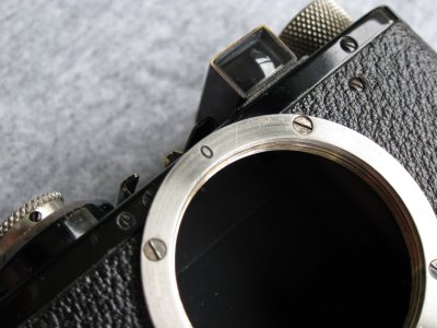

your leica was according to the serial number
original delivered as a leica 1 A with the fixed 5cm Elmar lens
this is from the number list on cameraquest which was provided to him by leica
converted to leica standard at some later point in time
it should have an 0 engraved on the top of the lens mount indicateing
it was set to the proper flange to film distance
I have one 5000 units newer - a leica 1 A covered to Leica standard
it was fairly common back then to have your leica updated to the latest
specifications - and interchangeable lens capability was desirable
the red spots are possibly just oxidation of the brass surface
my lens is from 1948 & being serviced currently
contacted leica - but they could only tell me - delivered in Berlin and the date in 1931
they stated it was not sent back to wetzlar for the conversion
they said if I sent pictures they could possibly comment on the conversion
which I haven't done yet View attachment 4858641View attachment 4858642
Thanks for the info. Yes, there is a 0 on the lens mount, like yours.

Leica 1a only had 1 serial number for body and lens. It was considered one unit - the number was engraved on the top plate - not the lens. When converted and the lens separated from the body, the lens remained without serial number.
If you have a converted Leica 1A and the lens has a serial number, that would indicate the lens is not the one that was on the camera when originally sold as 1A.
