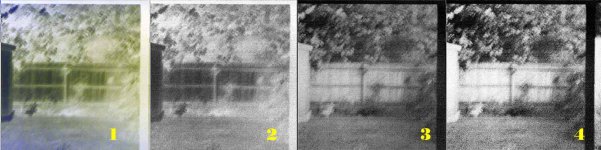

I'm sure I'll become notorious for these kind of things, but here goes!
A big thank-you to TimeFreeze. I now have 5 huge bulk rolls of 20 years out-of-date camera film to use up!
It's mainly 'Process E6' slide duplicating film.
Of course, E6 processing is next to non-existent, so much like my attempt with a C41 film, I've begun the endeavour to work out what speed a slide-duplicating film should be used at, and how to develop.
I've managed to get one or two photo's.
My question is this: What happens in E-6 processing?
When developed with typical b&w developer (generic Jessops brand) the negs appear black, but held up to the light with a yellowy tinge I can see a negative image creeping from beneath.
My neg scanner can only JUST cope with the film but strangely, when only scanned as a positive, and then inverted in Photoshop. The pictures have a really nice blue colour :)
Has anyone got idea's on stripping some layers* from this film so that the scanning is easier, and the negs don't appear with that thick dark layer? Some fun has taught me bleach strips ALL the emulsion! You live and learn I guess!
Anyone dabbled in E6 or other colour developing, or have any thoughts on how I should conduct my experiments?
*sorry about my awful terminology!
{positive/negative attached. Please dont criticise the exposure and blurring etc - handheld slow shutter speed on a test film, very rushed}

In E6 processing, these happen:
1. first development to create BW negative image.
2. reexposure or fogging bath to render the remaining undeveloped halide developable.
3. colour development to create a positive image in BW silver and colour dye.
4. bleaching to render all the formed silver in the emulsion (rehalogenisation) soluble in fixer.
5. fixer to remove the reformed silver halide, leaving only the positive colour dye image.
This description is simplified, but it explains what happens in the process. The chemistry involved is similar to the BW and colour developers but with some modifications to allow them to work precisely as the colour reversal film would require.
An E6 film developed in ordinary BW developer should yield a BW silver image. The yellow "masking" you saw in the developed strip is the yellow filter layer incorporated in the film. This filter layer is below the top (blue sensitive) layer and is present to prevent blue light from reaching and affecting the lower green and red sensitive layers. This yellow dye is usually soluble in one of the process chemicals used in colour reversal processing. But since you used a BW developer/ processing which did not affect the dye, the yellow dye layer remained.
You can 'correct' the image to yield "normal" looking BW images in Photoshop. Conversion to grey scale, then adjusting the levels and curves (brightness and contrast) accordingly is but one many of the methods which you can use.
BTW, duplicating film is designed to deal with pictures already on film. It imaging qualities aren't optimised to deal with "live" subjects. :)
Jay
Ash
I saved your attachments and edited them in Photoshop:
Using the left positive portion( refer to attachments below, numbers here correspond to the numbers in the photos.
1. The black value was established by using the dropper sampler tool in Levels by clicking on the blue margins of the image.
2. Desaturation applied to remove colour tinges.
3. After levels and curves adjustment.
Using the right negative portion:
1. The overall yellow mask was neutralised to white by using the white dropper tool in Levels. The area sampled was the yellow margin of the scan. The resulting negative image still bore some hints of yellow. These areas probably retained more of the yellow dye. This could say that ordinary BW processing can take out some of the yellow filter layer, but not much.
2.The negative image is further neutralised by desaturation. Conversion to grey scale mode could also work.
3. The negative image is converted (inverted) to positive.
4. After application of levels and curves adjusments.
