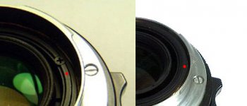

2. I happened to come across some info online, including some old threads that there were 2 different versions of CV Nokton 40/1.4. Not just MC vs SC. But rather a first series that had some mechanical problems and laters ones - that supposedly had those problems fixed? Something about wobbly lenses? Is that true? Can anyone confirm for sure? And if this is so - how can one tell which lens is which? Is there a serial number that starts a "new" fixed series?

On #2, I dont think there are 2 different versions of the 40f1.4 (apart from the SC.MC). All that I have seen have been the same. I have never seen any problem with wobbly mounts either. I have two early ones, one SC,one MC and they have seen a fair bit of use as my "walk-about" lenses on M2's. Still one of the great bargains too.
Not wanting to disagree with someone who knows Voiglander products better than anyone, I respectfully must disagree with Tom on this one. The first batch did contain a number of examples with stiff and uneven focus. To Cosinas credit however it made sure the second batch and onwards were corrected. The way to spot the difference is looking at the cam at the rear of the lens. The Type 1 has screws on the cam itself, the type 2 does not. Here is quick comparison photo. It should be said however not every Type 1 had/has focusing problems as many users reported them fine. I returned the Type 1 I had because the focusing was inconsistent through its focus sweep and the front of the lens began to loosen and wobble. A replacement from the 2nd batch was perfect. Both were MC lenses.
Woops I just noticed Tom has already seen an older thread on this matter I will leave my post up anyway so the photo is available in this thread too
