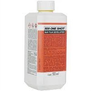

Hi Dave!The films I have enjoyed the most, and the ones I am currently committed to using now are: Acros II 100; Legacy Pro 100 (in the freezer); and TMax100. So far, the developers I paired them with are DD-X and Rodinal. I am still unsure of the best development protocols for both DD-X and Rodinal with these films. I think it would take me forever to settle those questions by trial and error.

As for Rodinal, I'm in the dark... haven't used it in years, so I'll be interested to hear what others say.
