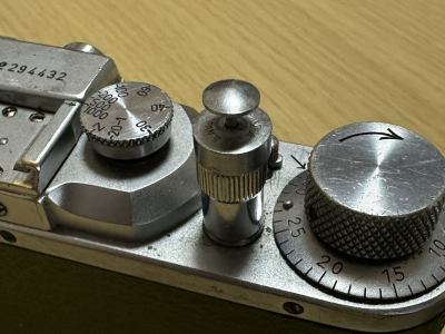

I was looking for a soft release button for my screw mount Leicas to use them with thick gloves when hiking winter mountains. I found one mounted on a Leica If but I don’t need another camera so I started looking into other options. The Nikon AR-1 has a similar thread but is too short. Therefore I came up with the idea of cannibalizing a cable release and use some parts of it to make a DIY shutter release button. It took some work with a Dremel, some grinding and drilling but finally I came up with a working copy.
Looks like you did a very nice job there!
