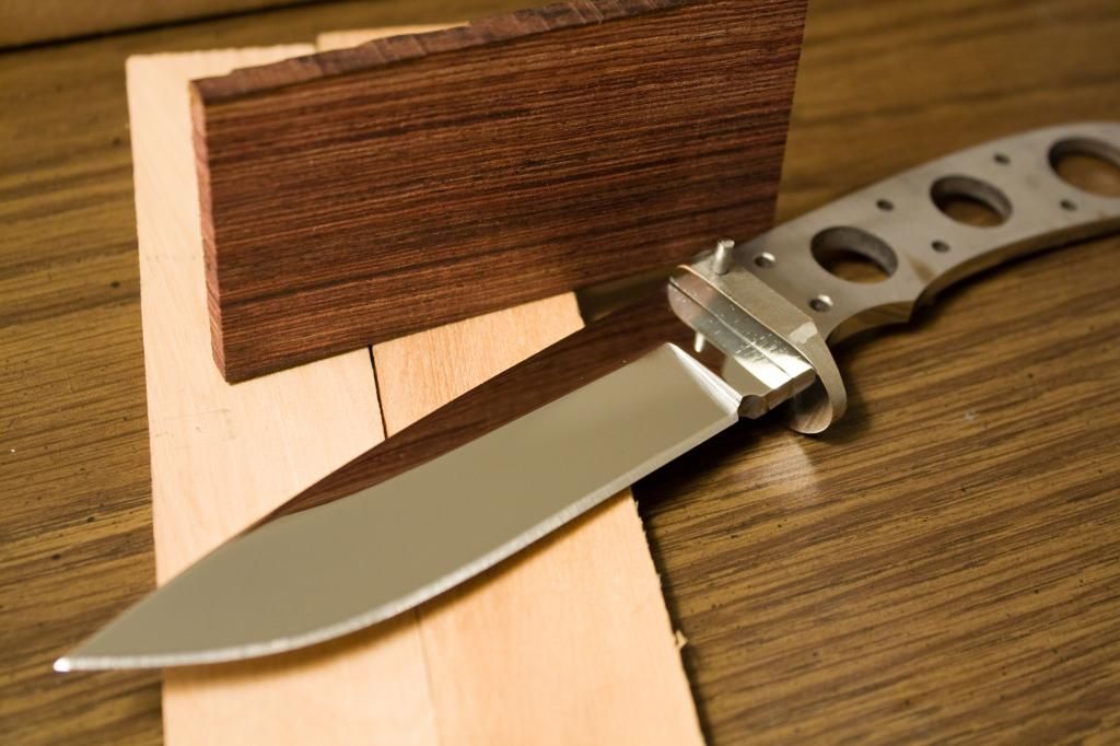

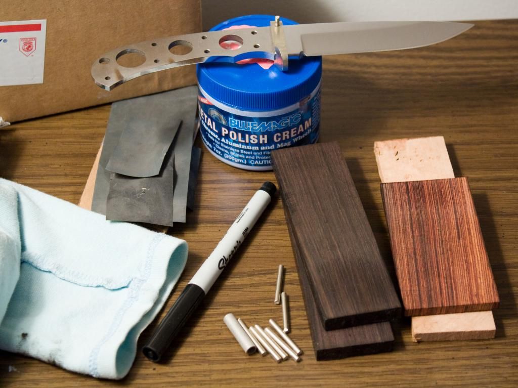

Laid out here is my knife kit ($50-ish - although I splurged to be honest), and wooden scales for the knife handle ($20-is I think). Just google knife kit and you'll see plenty of options.

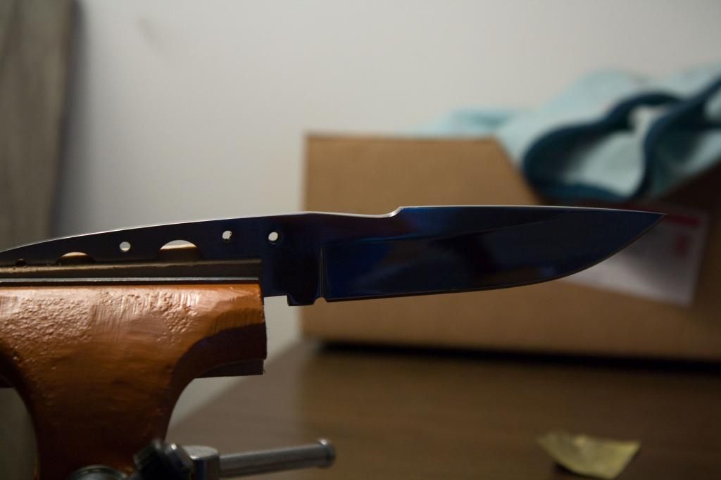

Here I've sanded and polished the blade of the knife. The knife is hardened tool steel so it's a really tedious process. Items involved were various grits of sandpaper, a dremel, and the metal polish I showed you above. All this is available at Home Depot and your local auto supply store. I've also dry-fit the guard (rounded piece with a pin through it) just to visualize how things will look.

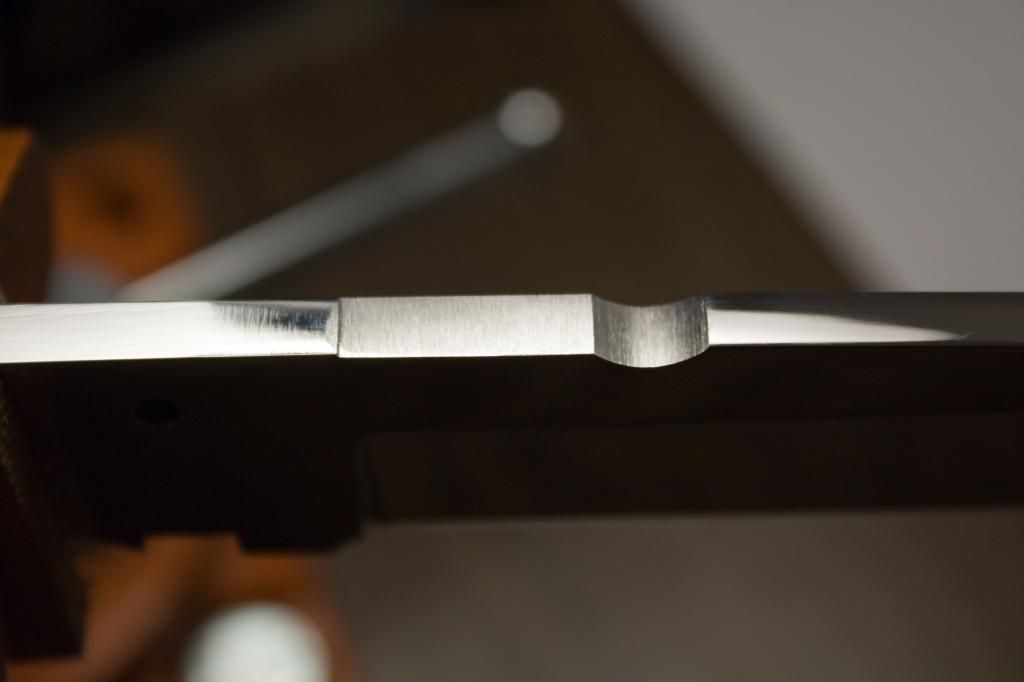

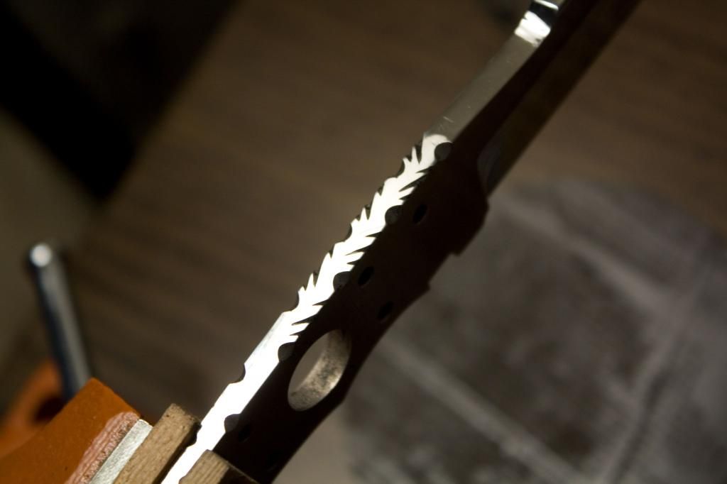

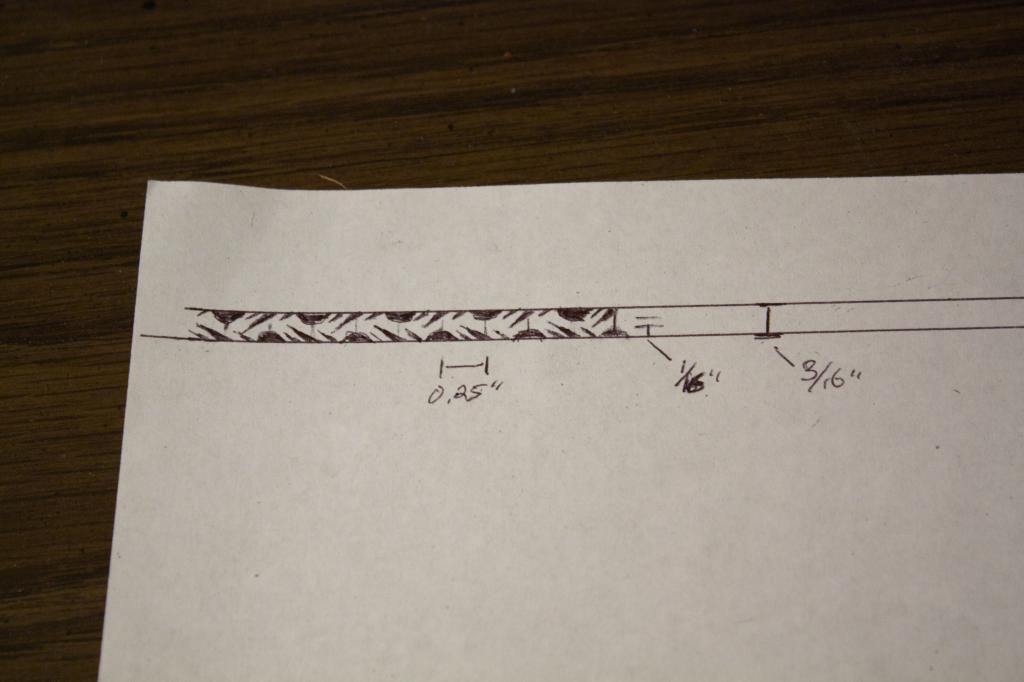

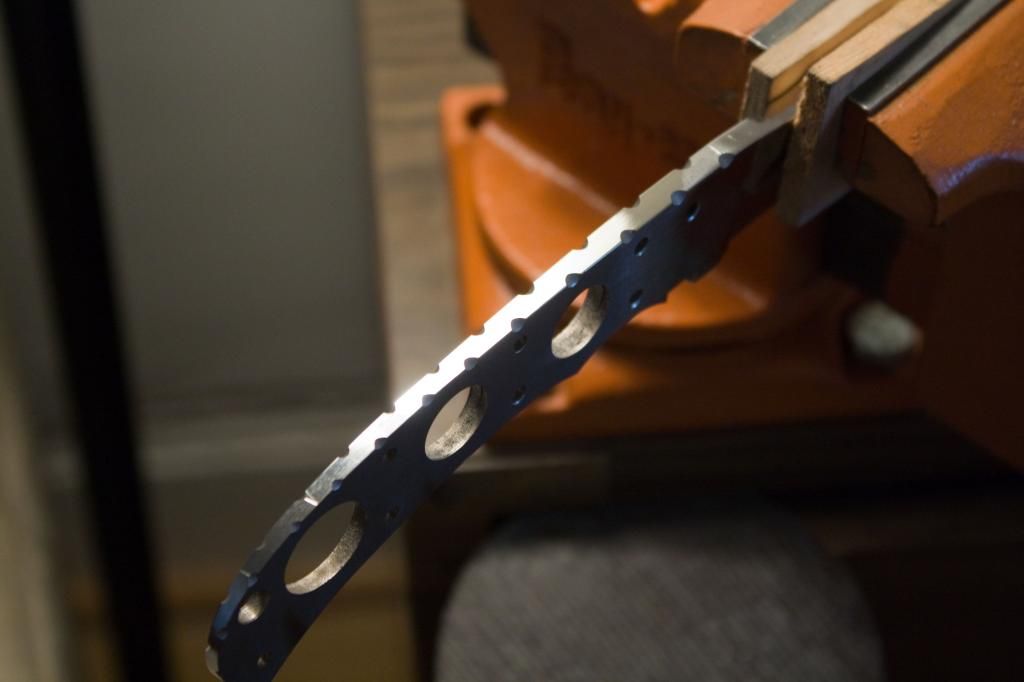

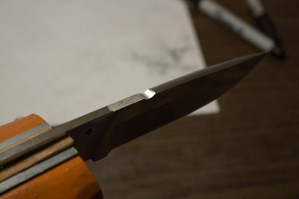

Next I begin removing material from the spine of the knife for my thumb. You may have noticed this conceptualized in my sketches above. This was done with diamond files purchased on amazon. You'll find them in sets with different shaped files, hence the flat and rounded tooling you see on the knife. Again, the hardened tool steel is really slow to respond to manual tooling. But, at least it's hard to make mistakes working so slowly.

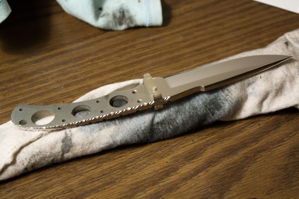

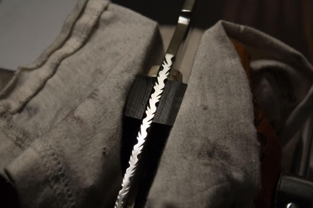

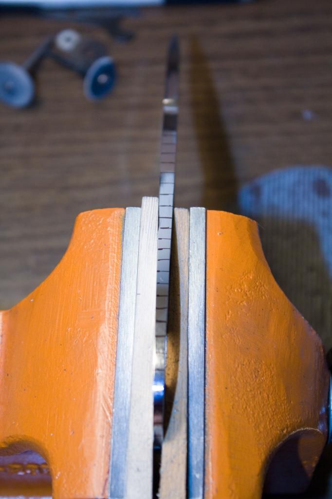

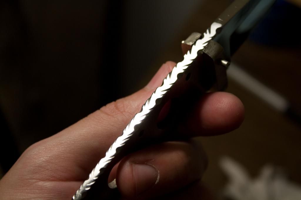

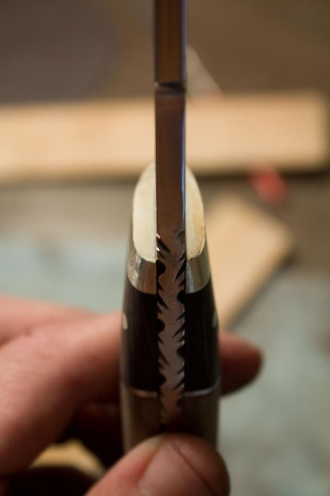

Ok next I want a pattern on the spine of the knife. This is achieved with the same diamond files. Google knife filework. Here is my intended pattern.
Transferring the pattern to the knife is a little interesting since the tang (handle portion) of the knife gradually narrows, requiring the filing pattern to adjust accordingly... just eyeballed it.
And now beginning the actual work.

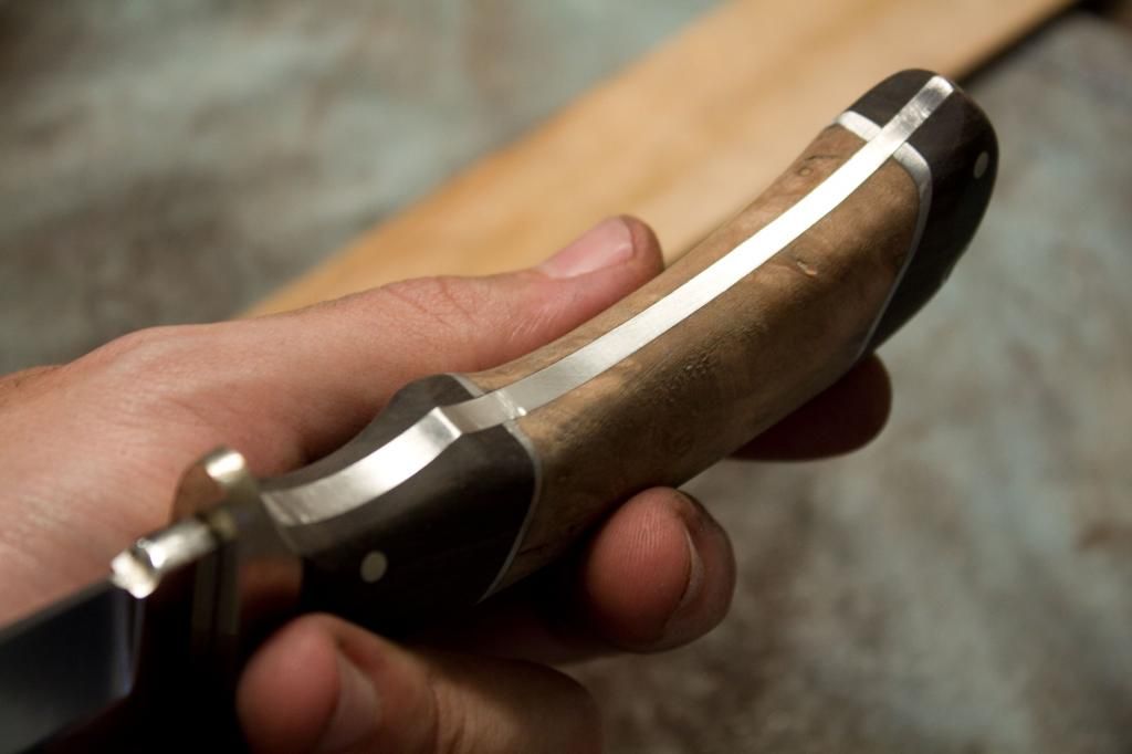

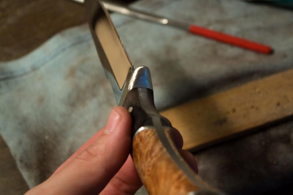

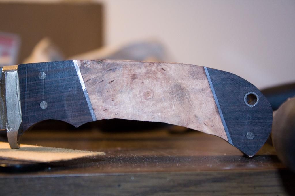

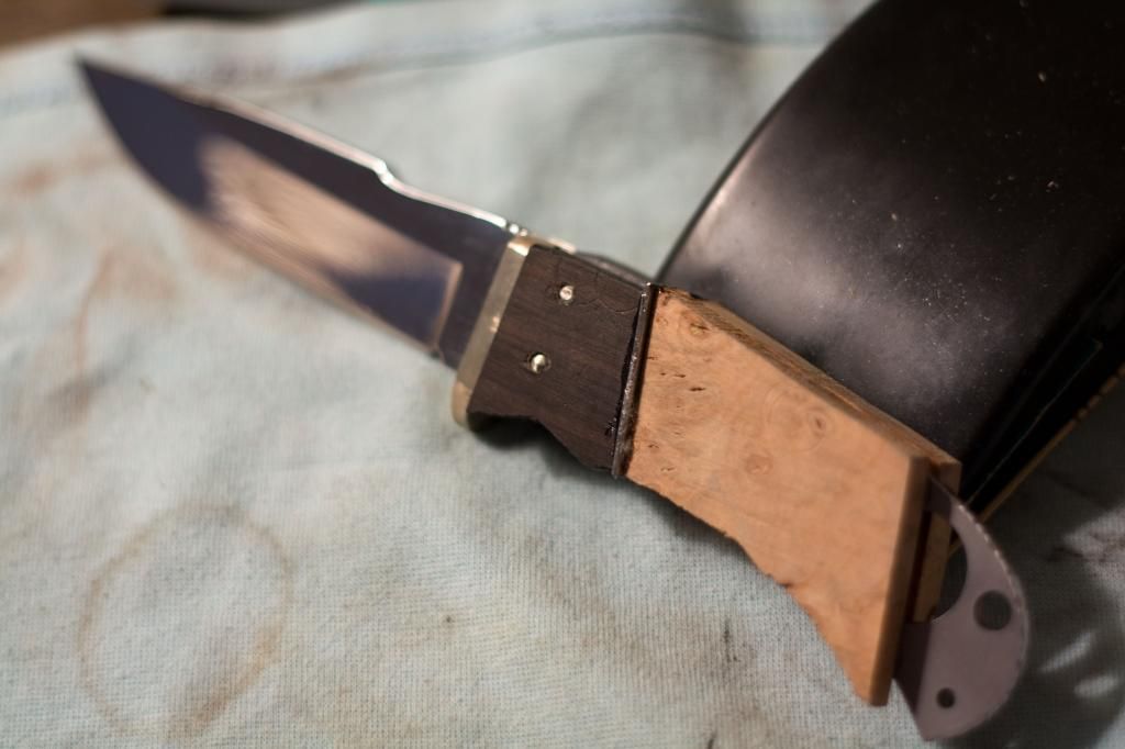

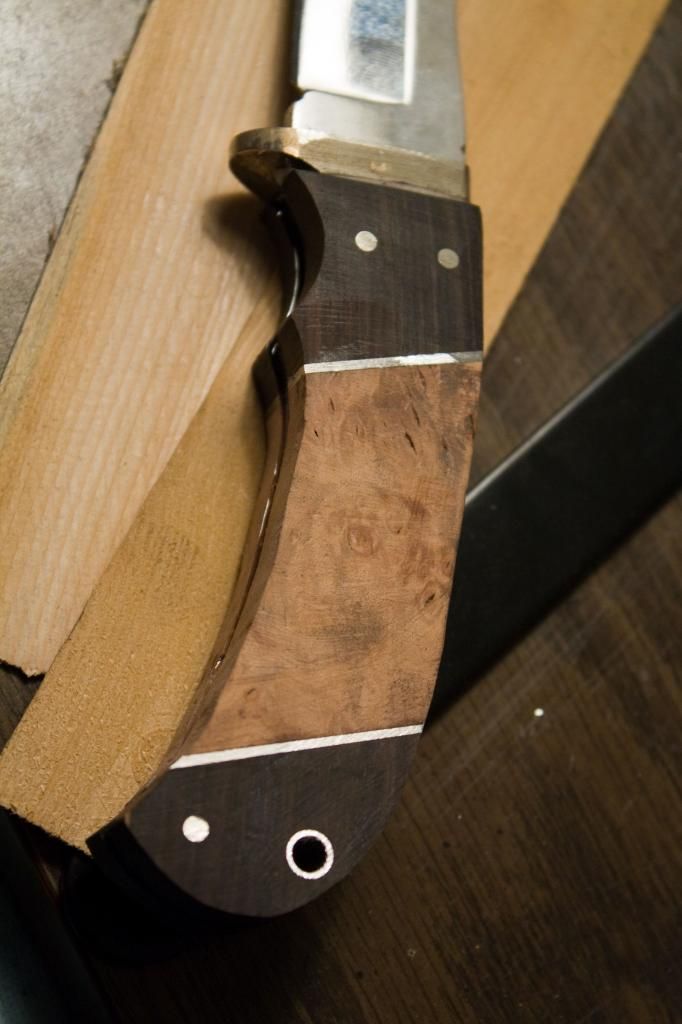

Here I am adding rough cutouts of wood for the handles. They are glued and pinned to and through the metal tang (handle part of the metal). The wood I used is ebony, and oak burl if I remember correctly. All that was needed here was a dovetail saw, epoxy, and hammer to expand the pins. Oh, I added some metal spacer between the wood for decoration. It was an old butter knife cut down with a dremel. Yep.
Continued...

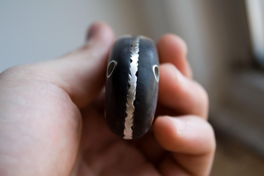

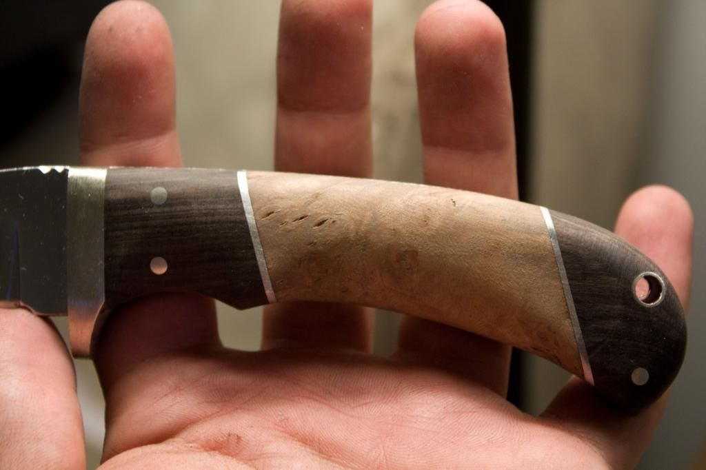

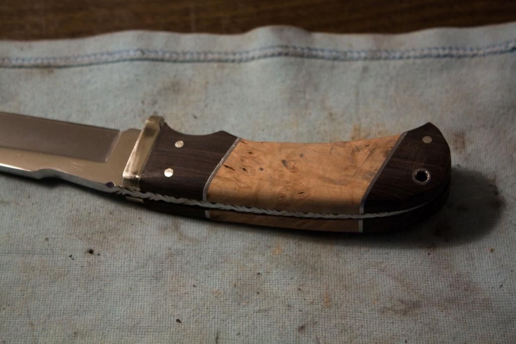

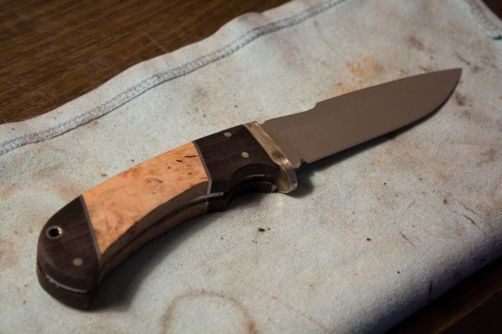

Once the handle material is suitably attached, the next step is to shape it into an actual handle. Here all I needed was sandpaper and some generic files purchased at a hardware store. First I worked on the profile. Then I worked on rounding off corners. Finally I worked in the "ergonomics" of the handle (for lack of a better description of the process).

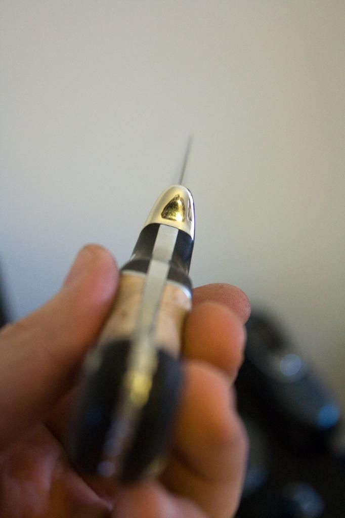

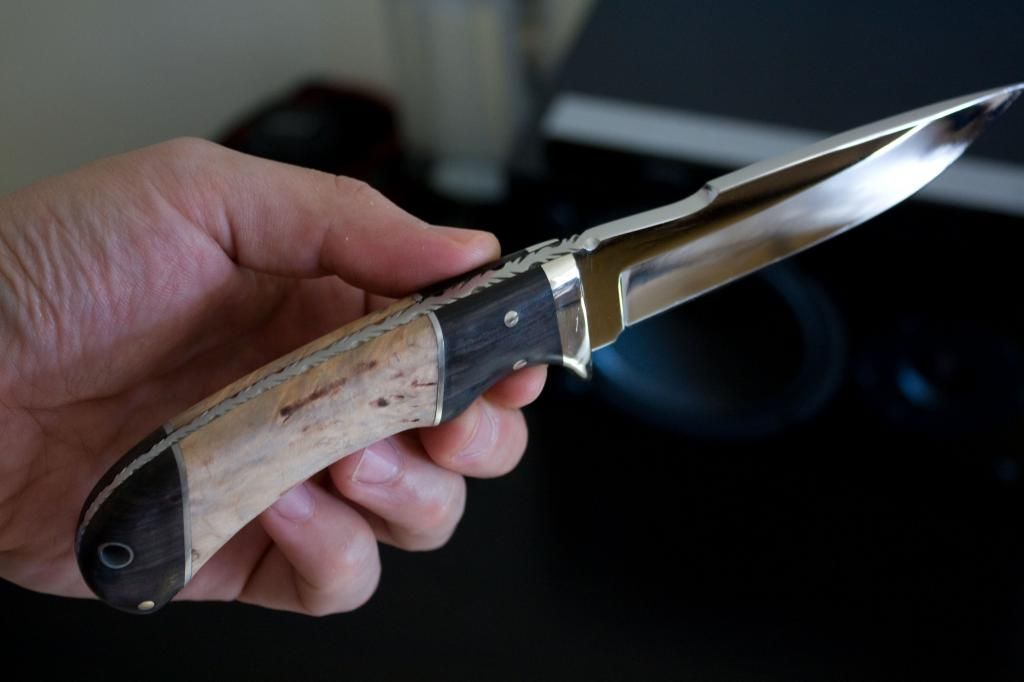

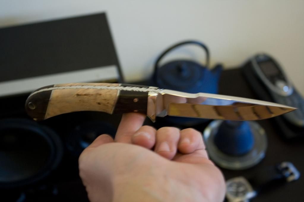

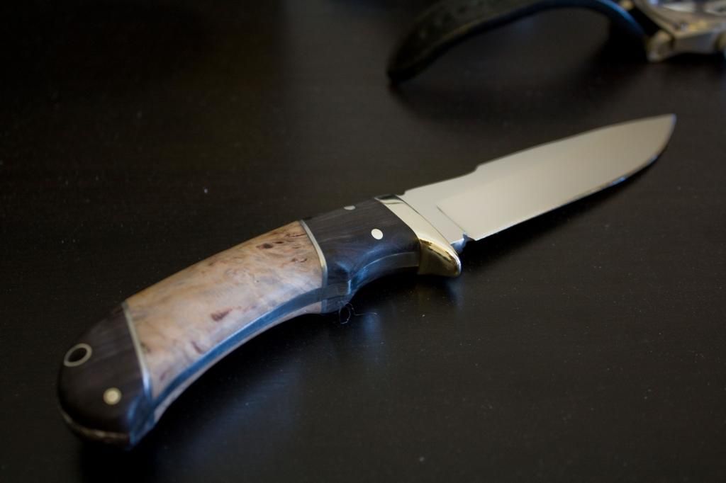

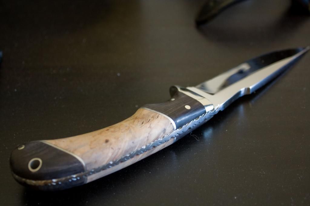

Actually, at this point the knife is essentially finished. Final steps included polishing, fine sanding, sealing wood, etc. etc. I don't think I actually took a picture of the 100% finished knife but you get the idea here:
I ended up gifting this knife to some family in China. I wonder how it's holding up... fun to think about where it is and if it's on display, in a drawer, or used to hell 😛

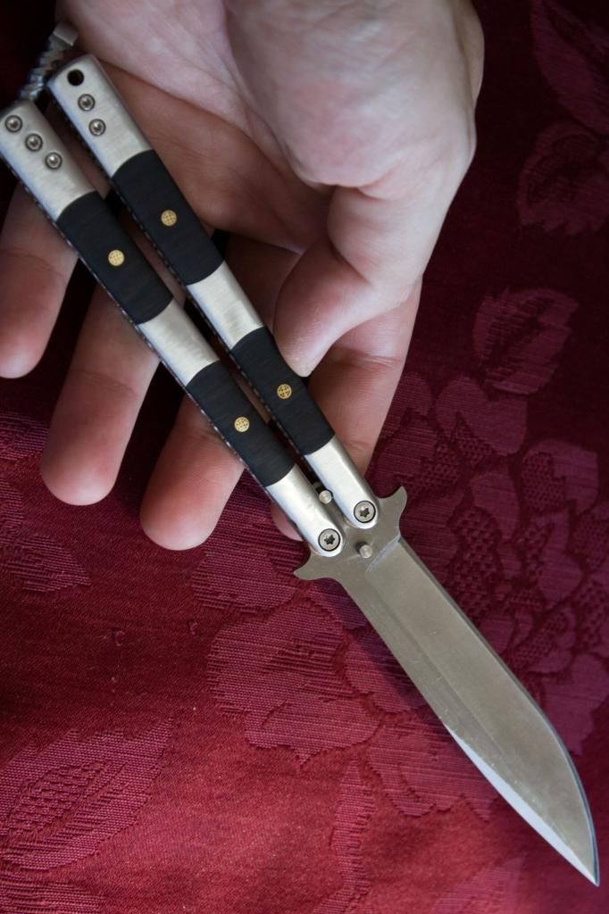

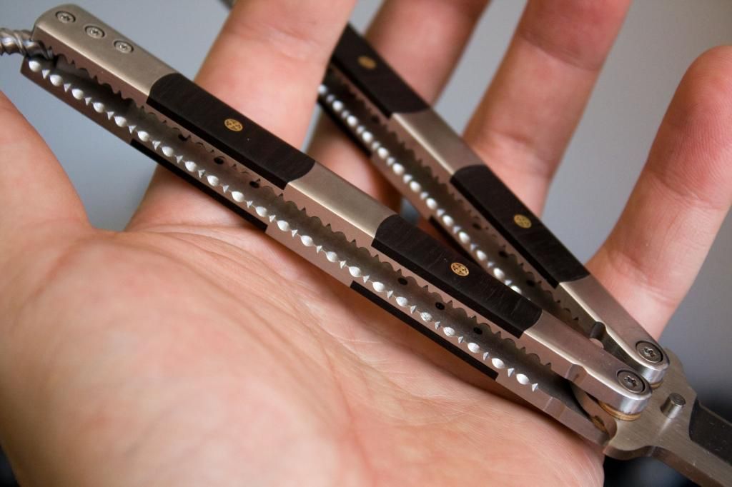

Regardless I did make a less involved knife from a kit. I don't even have photos of the process but here is the finished knife (again with the file work):

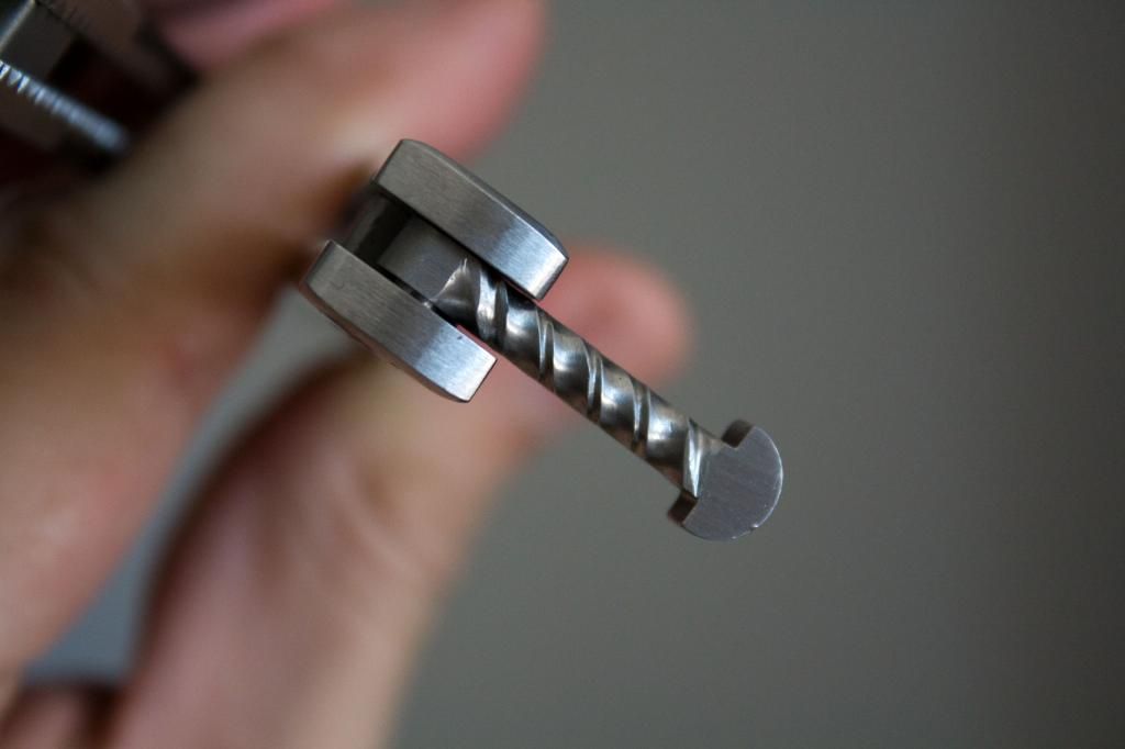

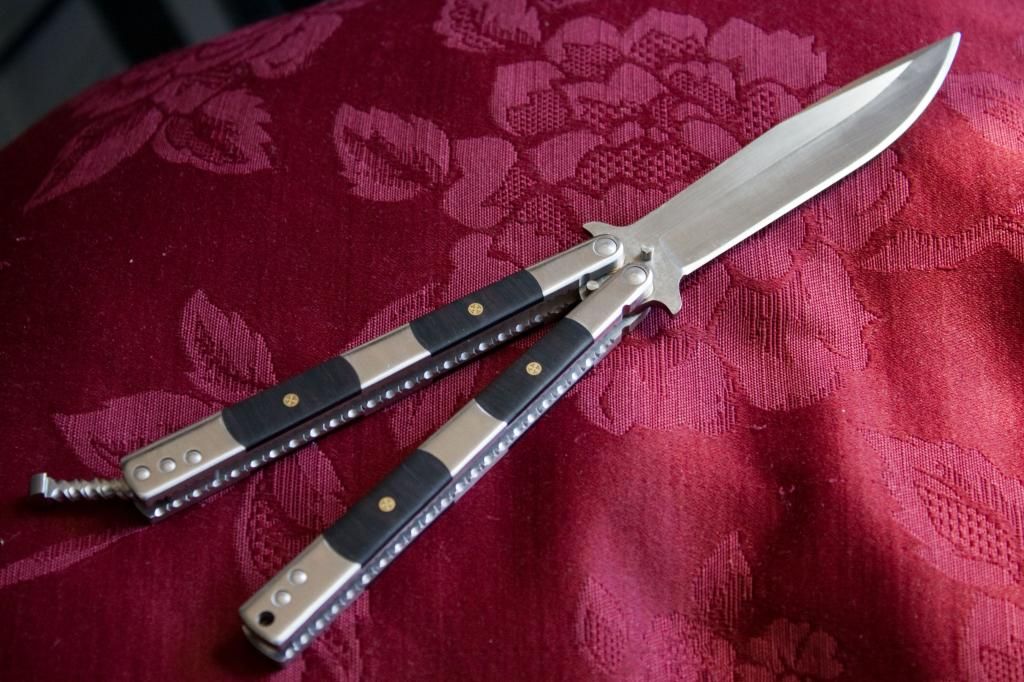

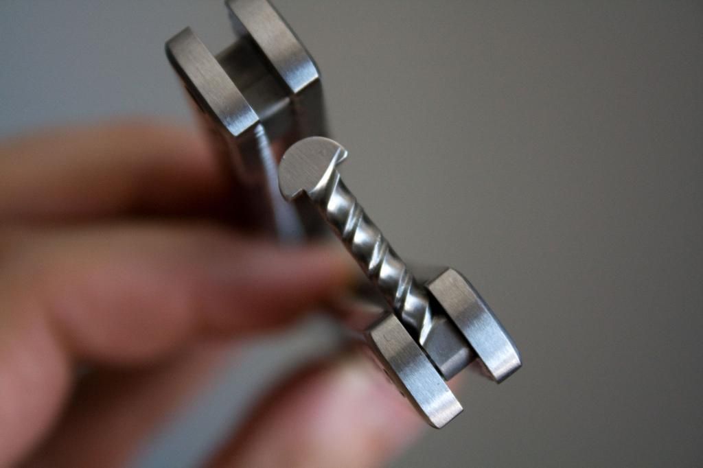

I especially liked the metalwork on the Balisong latch - great detail.
(*For those of you who might not know - polishing/working tempered steel is a btch!)
