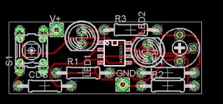

Now I'm looking for help from someone who knows how to use circuit board designing software (like Eagle or something else). I'd need to design a circuit board with SMD components the size of self-timer in FEDs and Zorkis - 38 x 16 mm.
If you can help, please send me a PM.

Well, no news since my last posting, but for Murray: the available height is about 10mm, maybe 8.
My friend was helping me with the board, but he has a lot of work now and no time for my crazy projects.
I'm attaching my friend's design of the board (of course the LEDs won't be on the board but there will be wires attached and LEDs will be inside or near the viewfinder). This is just the first version, so take it as such.
lex
looks promising!
take a look at the olympus OM2 shutter curtain (the pattern the meter gets reflected light from). the cds metering on this guy is renowned for its... well, lets just say it is a good meter!
