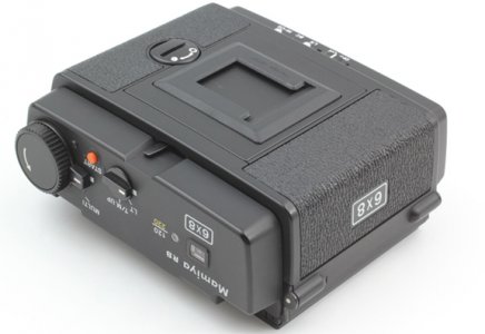

I am considering an RB or RZ67 Mamiya to add to my collection of users and shelf queens. I would also get a motorized 220 back which is 6x8 format. With that 6x8 back will I get a 6cm x 8cm image on film, or will it crop down to 6cm x 7cm due to the body having only a 6x7 backFor medium format, 120, I change film by swapping film backs (Hasselblad, Mamiya RB67) - that’s the beauty of the system. Not only color vs B&W, but different backs for low, normal, and high contrast (for Zone system aficionados).
opening? Or, is the rear body opening larger than 6x7?
The question is "where can you get 220 film these days?" Far as I've been aware, 220 roll film has been out of production for 15 years or more. I'm sure old stocks exist, but it seems foolish to spend the money on a film back for a film that is no longer produced.

Because the 220 back also accepts 120 film and with a 35mm casette conversion kit it will produce very wide 35mm panoramas and on the 220 setting it will do about 15-16 of them on a 120 roll. At today's film prices that is a big savings. BTW, I have several 220 rolls in my freezer just waiting to be used. Cheers!The question is "where can you get 220 film these days?" Far as I've been aware, 220 roll film has been out of production for 15 years or more. I'm sure old stocks exist, but it seems foolish to spend the money on a film back for a film that is no longer produced.

Hi-- For the Mamiya, the "6x8" back's image dimensions are 56mm x 76mmI am considering an RB or RZ67 Mamiya to add to my collection of users and shelf queens. I would also get a motorized 220 back which is 6x8 format. With that 6x8 back will I get a 6cm x 8cm image on film, or will it crop down to 6cm x 7cm due to the body having only a 6x7 back
