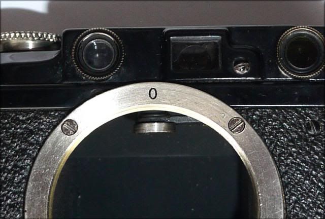

I have a very nice old Leica II, from the very first production batch in 1932.
It has a design point I have not seen in any other old Barnack. The focusing cam follower roller is quite narrow, and spaced farther from the edge of the lensmount than in other cameras. It appears that the arm mounting the arm is thicker than in later cameras, causing the position of the roller. I also have a 90mm Elmar from 1937, and it has an extremely narrow focusing ridge, even skinnier than on later models. As a result, the edge of the focusing ridge gets between the cam follower and the edge of the mount when this lens is on the camera, resulting, of course, in huge RF error.
The cam follower arm is quite thick, but it is not bent- it looks like it is supposed to be that way. I can replace the arm, or I can cut it down a bit so the cam follower is in the right place, but I am not eager to do so, as it appears that this is actually the way the camera was built.
Does anyone have some insight to this odd incompatibility?

The SN is 81302, which puts it in the first production batch in 1932.
As you can see, the cam follower wheel is rather skinny, and located far from the edge of the mount. I have never seen another like it.

I have a slightly newer Leica II. S.N. 148015, 1934 I think. Mine looks a little bit different than yours. The roller looks to be the same thickness but is higher up in the lens mount. The roller is perhaps only 1 millimeter or less from the lens mount and the outer edges of the roller are even with the mount.
Joe

I used to have a 79xxx body that was just like the one shown above - never had the same lens to try it though
Dez, does yours have the yellow/green tint to the RF window?
Dez
I have two early II's, 74510 and 90043 and both have rollers as skinny as yours, but are positioned somewhat higher. My III has a thicker roller.
The windows are untinted. There might be a slight yellowish tinge to both parts of the RF image, but I suspect this is just a property of the reflecting surfaces. There is nothing like the purposely yellow moving image sometimes seen.

I have a 5-digit SN Leica II (1932) that I bought from Johan a while back. Also with the "0" mark on the ring to indicate that it's been standardized.
I have shot my 1937 90mm Elmar with it without any focussing problems. I'll check the follower later when I get home today.

Leica II - has "skinny" RF wheel and "straight" arm. RF main window ( rewind end of body) has slight yellowish tint. Moveable image ( wind-end ) has no tint.
Leica III (both cameras) - have thicker RF wheel and "dog-legged" arm. No tint in either RF window.
