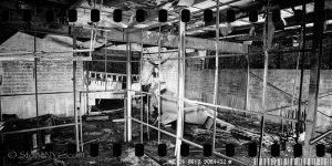

Oh if we are sharing images...
XX @200 in Rodinal pushed 1 stop.
Warning: I shoot Nude Models 🙂
