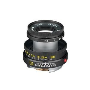

On another note, I also found what appears to be a 3rd newer M version?
Source:
http://www.amazon.com/Leica-Summicron-Manual-Focus-11826/dp/B00009V3FL
The lens shown in the attachments is currently going for US $749.99 - which is just over £400 and just within the budget I set myself for a 50mm Collapsible lens.

Regarding the collapsible lens you found via amazon: this is the latest (now discontinued) version of the collapsible f2.8 Elmar lens, so no Summicron. It focuses down to 0.7m. It will not give you the vintage look; some users here on RFF prefer its look compared to the latest fixed barrel Summicrons.
