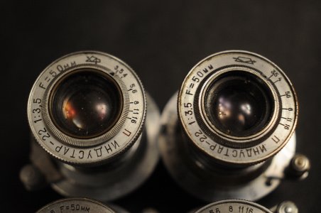

I've found the Industar-50 in Collapsible mount to be well-made, and optically even better than the Industar-22. There is sample-to-sample variation, and some of the earliest Industar-22 use German glass- figure through 1953. There is also a Rigid Industar-22, usually early.RIMG0049.jpg

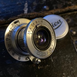

I’m not even sure what version this one is. It appears to be coated so it must be post war and I assume it’s an Elmar copy. Can someone w tell me which model?
I don’t even remember when I bought it but think it was on a Russian camera that picked up 25 or so years ago. I don’t think I ever shot any film with it but shooting on digital it’s quite respectable. Matter of fact it blew me away how good it is. I’ve had several 3.5 and 2.8 Elmar and I’d say it’s easily on par with them.
