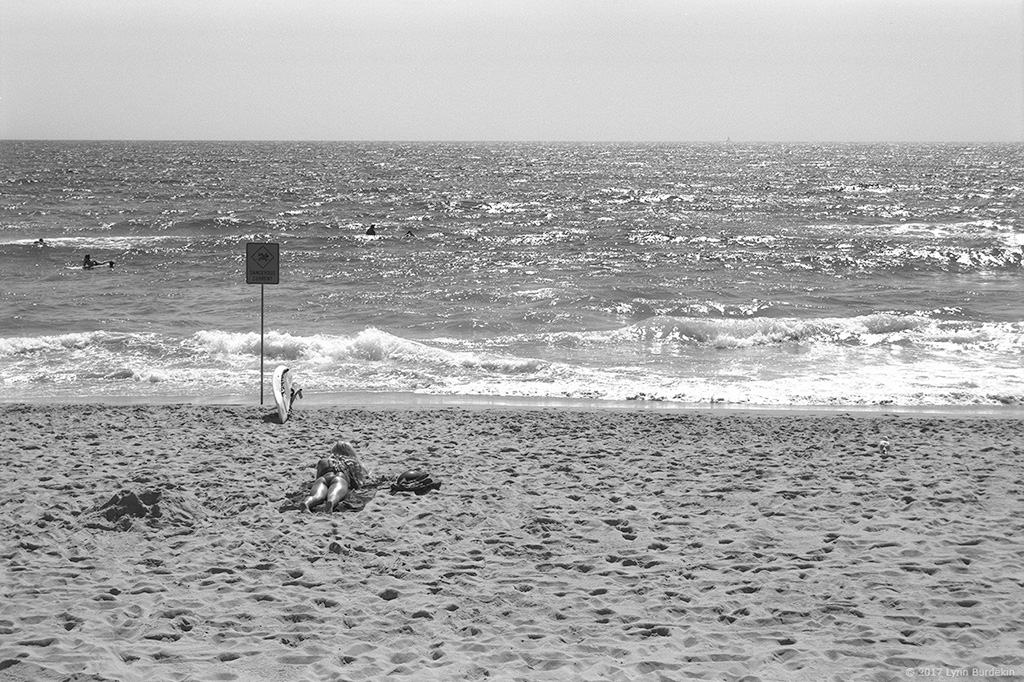

My first roll of P30 exposed at ISO100 and dev in XTOL 1+1 12m 20C with 6 rapid inversions every 30sec. V700 scan. IIIc with a CV21/4 LTM.
The negs have high acutance and are very contrasty (easily tamed in LR4).

If the negs are "very contrasty", I'd cut back on the agitation. IME, too much agitation causes much higher contrast build up.
For scanning, I go the other way and minimize agitation. It's always easy to add contrast*and obscure data when needed, but reducing contrast ultimately runs into the scanner's limitations and lack of detail information.

P30 is inherently contrasty. There are monstrous threads over on APUG (now Photrio) how to deal with the contrast. Post-processing definitely helps, but controlling contrast during development is the real solution. Choice of developer has a big impact on contrast. Version 2.0 of their “best practices” PDF is very helpful.

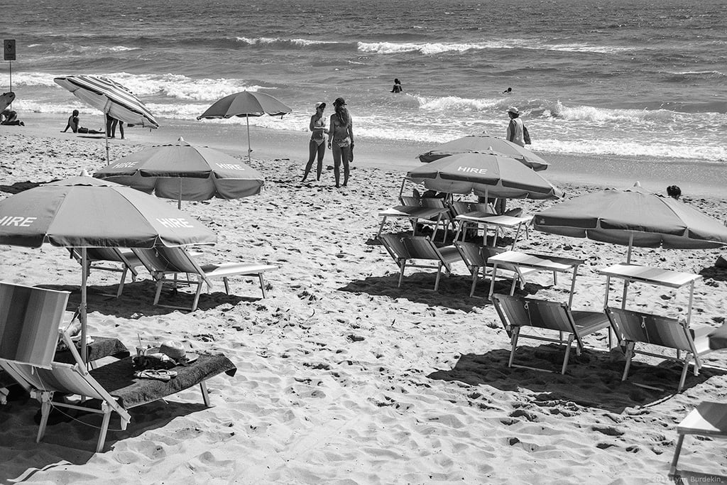

From the same roll as images posted earlier, P30 @iso100 in XTOL 1+1, V700 scan and LR4 tone adjustment.
Ferrania P30 at Manly Village markets, Sydney 2017. #814 by lynn's snaps, on Flickr

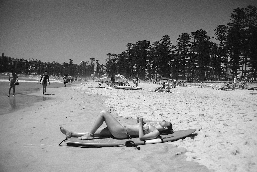

from the same roll - P30 in XTOL 1+1
Manly beach, Sydney summer #832 by lynnb's snaps, on Flickr
IIIc CV21/4 LTM
IIIc CV21/4 LTM

Dave, no concern, it's just different - it's got a response unlike anything I've used previously. Blue skies are darker as are shadow areas. Also it gives a glow to the highlights as if there's no antihalation layer. But these are things you work with when you use the film. If I try it again I'll use Ferrania's recommended development. I think the film will work very well for portraits.
