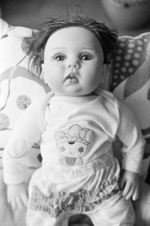

I did a some bracketing shots 800, 400, 200 for two different scenes. I used an incident meter for both scenes and made a sanity check with in camera meter. (Nikon FM2, sort of center weighted I think) I scanned the film on my Plustek Opticfilm 120 without any corrections.

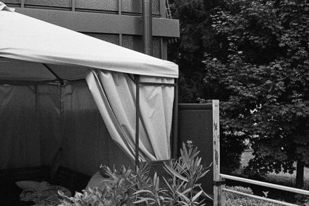

Scene1: Outside, tricky scene with the super dark interior of the tent. Horrible overcast weather. The shot at 200 is best. The tent is light brown, not white.

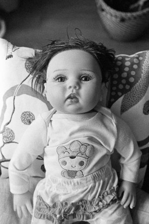

Scene2: A doll, very close to window with overcast weather outside. I like 400 version here. The others are ok I think. One problem is that the Nikon FM2 with Ultron 40/2 only do full stops. Bad setup for scientific tests. I think this scene is exposed slightly brighter than the first.

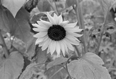

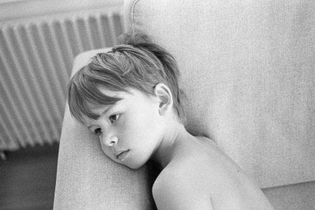

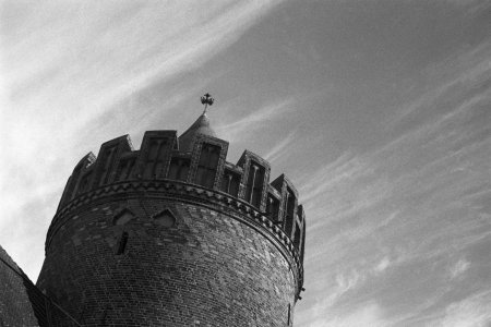

And here are a few random shots from the roll. In camera meter set to 320.

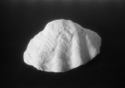

And here is a couple of super contrasty pictures. Bright white shell on almost black mahogany. I think there is some glow there.
Summa summarum: I think this method is alright. I like the grain structure, and the general look when exposed slightly south of 400. Applying some curves in post could improve them as well. Maybe shooting at 240 is some sort of sweet spot here.
But, is this better or worse than the standard? I really don't know.

One comment about testing: to test contrast, use light, jot the subject - your ‘contrasty’ scene is in flat light, where it really doesn’t matter if the background is very dark and the subject is white. Find some contrasty light to find out how your matering-exposure-development combination handles it.
Good point about the light. From this test roll there where a few bikini shots of my wife in harsh mid day sunlight. I'm forbidden to post them here, but they are alright 🙂 No blown highlights or blocket up shadows.

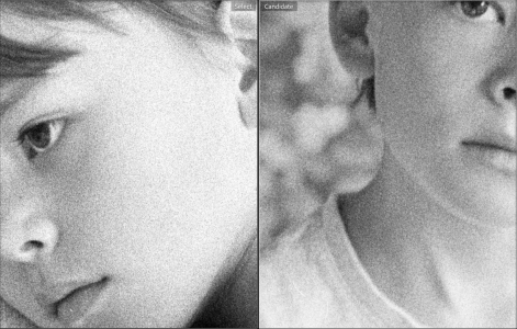

So I did develop a roll Tri-X @320 in Rodinal, 1+50, 20C for 12 minutes, Ilford agitation. Not a scientific test. Compared to the previous 18.5 minutes. Grain is about the same. Possibly 18.5min grain very slightly better. And there are not really any edge effects that I can see in the case of 12min.
Zoomed in at 100%: comparison of face in soft light. Left 18.5min, right 12min.
I will pursue the way of minimal agitation. But both 12min and 18.5 are slightly too long for Tri-X @320. 11.5 minutes for 1+50 with Ilford agitation would be better. And that takes me to a minimal agitation time of 17:15.
