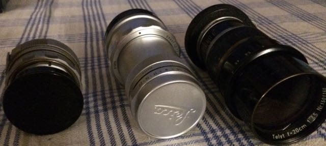

So the other day I came across someone selling a bag of Leica goods. He advertised a Leica M3 and a few assorted lenses + accessories. I managed to identify the far left lens as a Summicron Rigid DR and quickly bought the lot.
I had no intentions keeping the M3 nor the lenses. But I figured I'd shoot a quick roll with the M3 and the Summicron to better advertise them as at least tested when re-selling them.
