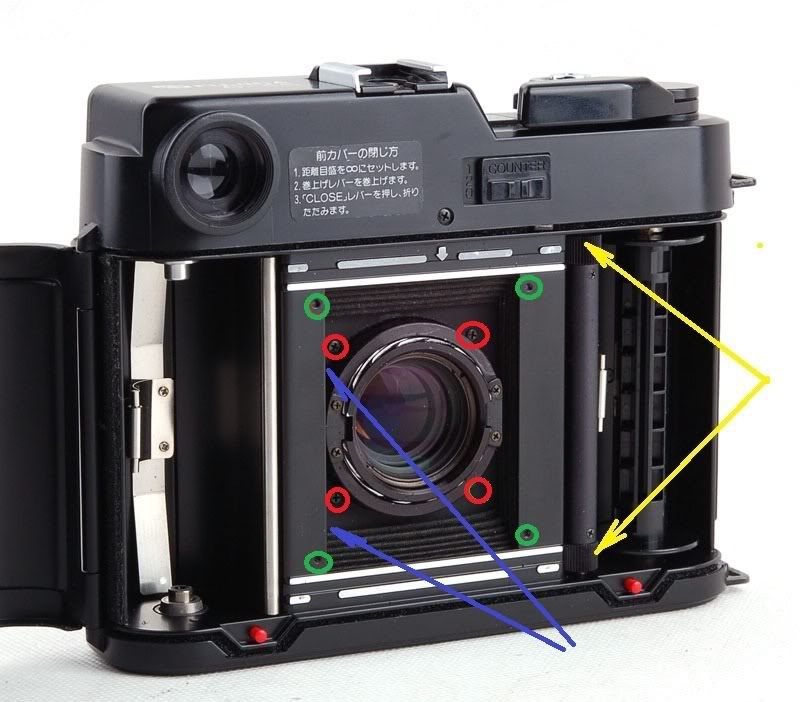

Yes, I did. Actually it's not too difficult. All you need is to unscrew 8 screws (4 red and 4 green, see the figure), replace an old belows with new ones, and fix it with the screws.
http://i21.photobucket.com/albums/b275/Paolo_Cocoa/Rangefinders/GS645_back.jpg~original
It is easy to unscrew all 8 screws, and it is easy to screw back red screws. But it is not so easy with green. But you can do it if one has long and flexible fingers and a proper small screwdriver. Another way to do that is to remove a lens. But I have no experience in removing the lens

Thanks. I found a local shop that will do it for $85 (I supply the bellows). That's worth it for me, as I am not too handy.
