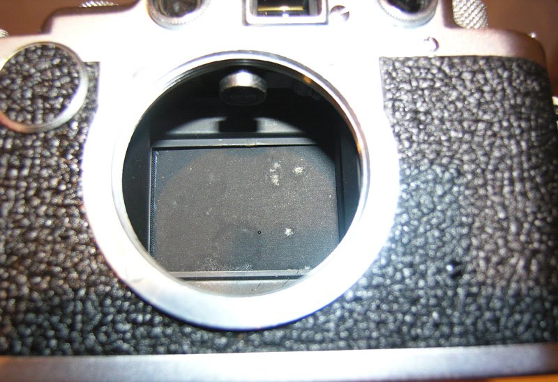

Hi everyone,
I've recently purchaced a Leica IIc and i've discovered that the shutter curtains hane some spots on them that look like fungus. Is there a way to get rid of them? I attach a picture to see.
Thanx !
Exposing the spots to sunlight for a while (camera not loaded) should fix them if they are fungus -- BUT I must say that I do not know if that could harm something.
isopropyl alcohol! fungal spores are omnipresent, it's moisture that creates the problem, just keep silica gel in with your gear. Repairmen worried about cross contamination, crazy.
