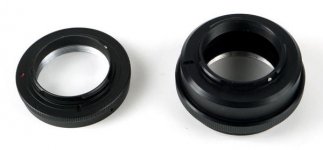

I thought I might add a few words about the adapter I used for the photos at the top of this thread. I actually have two adapters. One for Leica thread mount and one for Pentax M42 thread mount. Photos from both are at my Flickr set: Panasonic G1 adapter madness. I bought them both on eBay. The Leica thread mount adapter on the left was from jinfinance in China. It was $78.50 with free shipping. It focuses at infinity and mounts on the G1 just fine. The Pentax M42 thread mount adapter on the right was from ciecio7 in Poland. It was $50 plus $8 shipping. It wouldn't focus at infinity. I contacted the seller and he quickly replied with a solution. There are three set screws holding the bright M42 threads in the black body. I removed the M42 thread body and there was a shim under it that I removed. It then focused at infinity. Both adapters have a similar design and work as they should. They both mount on the G1 smoothly. I'm most happy with them.

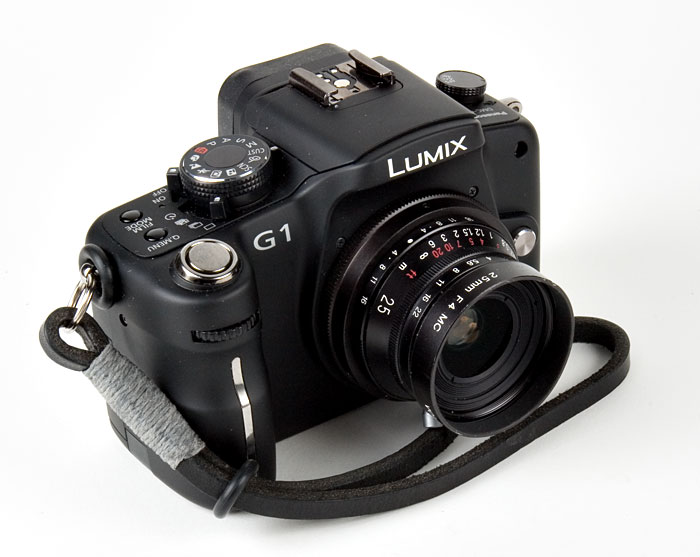

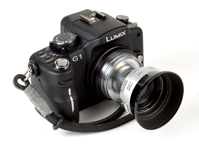

These are the two Leica thread mount lenses I have that will mount on the G1.
My Summitar 50/2. The Summitar won't collapse without hitting something.
My CV 25/4 Snapshot-Skopar.
