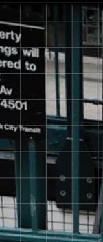

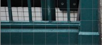

I just imported the picture into lightroom and put a grid up over it after rotating the picture so the slats are vertical. Only one slat is fully visible, it is straight. The attached is at 300% view.
