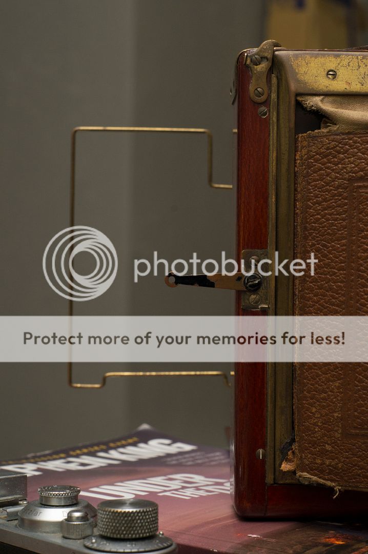

Last pics I promise. This is what came with it and I definitely see your point, sevo, that it's likely to be the same manufacturer as the original plates. Unfortunately I have no way of confirming whether or not they are but I do have a number of the black no-names that you describe. They haven't survived anywhere near as well as the Tropen Ideal ones. I'm sorry about my lack of knowledge when it comes to naming each of these items, I know literally nothing about this type of camera beyond what I've researched over the last two days on the net.
Ron, the sports viewfinder is complete as far as I can tell (there are no empty/filled screw holes in the body that I can find) although it's a far less complex version than the one on the links you posted. It took me a while to figure out what it was. The lens was upside down on the camera when I got it, probably as you say because it's either not original or has been removed before. I removed the lens to give it a light clean and put it back upside down! I'll remedy that right now.

Great, the sportsfinder is complete - I missed that in the other pics, apparently no screw holes there either ....
indeed the lens / shutter combi could original - btw in many cases one was given a choice of shutter / lens combinations so one can find the same camera very often with a different lens / shutter
That was a extra size (or version) designator behind the three digit base model number. It only was consistently introduced years after ICA started, none of my pre-war or WWI cameras have it. Their earlier cameras usually had a three digit number (and different numbers for each size) - some even had completely different identification schemes as the companies that merged into ICA used up their earlier parts inventory, sometimes for years...
Yup, indeed very early Ica camera's may not have that extra digit... but IMHO this is no ICA.
