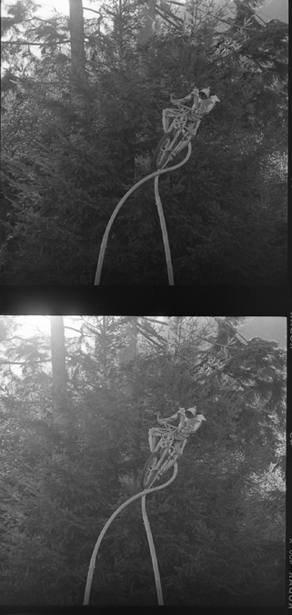

Hello,
I'd like to solicit your comments to help diagnose a defect on this 6x6 frame shot on 120 Ilford HP5 Plus:
The issue is the band of higher density at the bottom of the image. This was shot with a (new to me) Yashica Mat 124G. The adjacent frames look okay. Developed for 9 minutes in DD-X in a Paterson universal tank.
  • Defect appears on the negative and extends into the margin/rebate. So it's not a scanning issue.
  • The defect is denser the left side and graduates to thinner on the right side, which is visible in the scan and in the negative.
  • This frame was 2/3's into the roll (frame #9). The last frame #13 also has a lesser but similar band at it's bottom (on the inside, adjacent to frame #12).
  • Neither were shot in direct sunlight and camera has it's leather case attached, so unlikely to be light leaking from around the back opening.
  • The frame would have been oriented 90 degrees sideways inside the dev tank, so the band would have been sitting vertically. Thus it's probably not a matter of low liquid level.
  • Did not occur on previous roll.
Any thoughts?
I'm thinking it could be:
Possibly some sort of leakage carrying over from the frame next to it. Looking again at the adjacent negative frame on that side, it has a dense sky on one side that appears to be bleeding into the margins somewhat. I can't tell for sure but it might be bleeding slightly over into the frame in question. The other frame I mentioned also has an adjacent frame with some dense areas bleeding over into the margin. What could cause this? Could overexposing a sky cause defects on an adjacent frame? Or perhaps some development problem, use of a squeegee, or drying issue?
Other than that, perhaps a random leak of some kind, random static, or a portion of the frames were stuck together inside the developer roll...
How did you develop this roll? Was the agitation regular? As pointed out above, it could also be an inadequate amount of developer. Did you check the internals of rhe camera for bright spots or even a loose baffle? Lastly, have you done any more rolls and had the problem repeat?

It's not a darkroom or development issue.
I suspect that it is a light strike from a very small light leak across the top of the camera back, probably along the back hinge. It's lack of appearance on other frames suggests that its a leak which requires some time to expose. Also, it would not be blocked by the case bottom alone. To test: load another roll; put black tape along the top seam of the back, and leave open to light for an hour or two. See what happens.

Yeah, could be a leak or reflection I suppose. Since I had the case attached, the only potential place would be coming from the top hinge. Or as Marty mentioned, perhaps the chrome film roller that sits above the internal baffle.
But it's strange as it only happened when there was an nearby frame with an overexposed sky or area near the adjacent edge - so at the moment I think it's likely some sort of bleeding from overexposure.

I've been shooting TLR's for over twenty five years and never had a transport roller make a reflection on a neg. Not saying it couldn't happen, but it never happened to me. If it's not a development issue, sometimes the film can be loosely wound on the take up spool and this can let a little light onto the film when you open up the camera.
I would ck the camera carefully for light leaks on the back, shoot another roll of film, and make sure that the levels are OK in the developing tank. If I had to guess, like someone said above, it may have been some of the film touching on this part of the neg on the developing spool.

I went and shot another two test rolls today and just finished developing them. I taped up the back of the camera with some gaffer tape to eliminate potential light leaks. Same time, same film, same light/conditions (setting sun), same metering (rated at 320, metering off the shadows or mids). And of course I developed using the same method. On the first roll I deliberately took a few shots that would have over-exposed areas near the top of the frame. You can see the result here:
So, it seems over-exposing can cause the bleeding/spillage into the adjacent frame. The Yashica tends to space each frame a little different, so some are far enough away where it doesn't harm them, while others get a nasty band of spillage (halation?) from the previous shot.
On the second roll of film I avoided shooting towards bright light sources (sun) or reflections, and it seems fine.

Thanks for sharing. It does look somewhat similar. One difference seems to be is that on my negatives, you can see that the bleeding/halation always terminates at a hard horizontal line. I wonder how T-Max would fare.
Yeah, maybe a pressure plate issue. Mine "feels" okay, not too loose or anything. Maybe it's a design thing. I have since found a handful of other mentions online of TLR's including Rollei's behaving like this.

Put the film back in the camera as it would be sitting when shot. I bet you'll find that the hard line matches the bottom roller in the camera. The light is possibly both reflecting inside the camera and halationing (?? is that a verb even??) through the film. Like the first frame you show, the film was fogged before it was exposed, as it came off the spool and was 'waiting' to be the next frame.
Older YashicaMats had a very unflat black paint in the film chamber. You can add flocking or true flat black paint to reduce the internal reflections and it reduces veiling flare throughout images- a very nice upgrade. I don't remember if the 124G had a better material inside there.
Drop me a note with an address and I can send you a piece of telescope flocking material, thin flat black felt-type sheeting with adhesive backing. You can cut it to fit inside the chamber.
