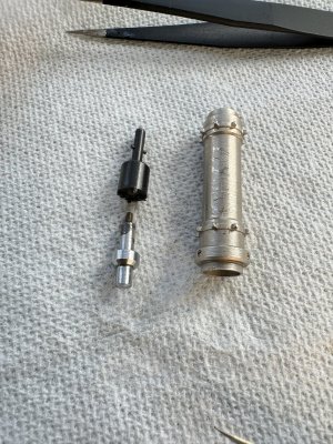

Thanks for this post. It’s very illuminating of the mechanism.

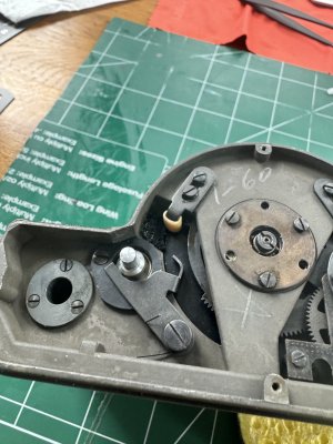

My horizont has the opposite to the problem you have described.
The rewind release button appears to be stuck somehow - it can’t be pressed any further or pulled out. The sprocket roller is not released and film can’t be rewound.
Based on what I read here, I am guessing the black piece you have identified from inside the sprocket roller is stuck down at the bottom and not pushing up to release the rewind. Does that make sense?
With the winding/shutter trigger assembly removed, the sprocket roller can be moved freely in both directions.
I have not removed the sprocket roller from the camera body (how?)
I have tried grabbing and pulling the black piece up by reaching it with forceps, but I see that wouldn’t work if the release button is screwed into it.
Otherwise the camera seems ok - turret moves smoothly and the light seals were replaced before I bought it - it was advertised as having been serviced and functional.
Would appreciate any suggestions on releasing this jamb.
Thanks
Arash
As I recall you take the spocket out from the bottom. There is a lever that holds the rewind button down (for rewinding) which you have to remove. Make sure that lever isn't locking the button in the advance position. On this camera that lever was causing me grief so I just removed the whole thing. Means I have to hold the rewind button in the whole time but that is fine. I don't remember if it was locking it in advance or rewind though.
If that isn't the problem watch the position of the spring before you take the lever off. Then I think there was just a cover that release the spoket roller out the botton. I don't think the advance mechanism had to be removed from up top but I might be wrong on that. After get that out it should be easy to see what is going on.

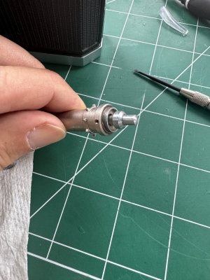

Thanks for the reply.
The rewind lever looked as pictured and seemed to be ok - but of course I am not certain.

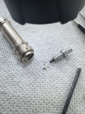

I have removed the roller from the camera.
Also removed the three tiny retaining screws from the sides of the roller near the bottom end.
The rewind button will not budge.
Have applied sone WD40
Tried pulling, pushing, turning clockwise, counterclockwise… it will not come off.
What am i missing?

Pretty sure it is standard thread direction as it turns clockwise on film rotation which would tighten it.
Does your button move up/down inside the sproket or is it still locked in position? If it is locked I'd think you might have some corrosion inside between the black piece and the sides of the sproket.
WD40 is actually pretty lousy at breaking stuff free. PB Blaster works much better IME though I wouldn't use it on this. I'd probably soak the whole thing is something like naptha for a couple of hours and see if it helps loosen it up.
Maybe don't try unscrewing too hard as you won't want to break the little pins at the bottom of the black piece or snap the screw itself either. You really just need to get that mechanism sliding up/down smoothly to get the rewind working properly. After soaking maybe stand the sproket upright with the button on top and lightly tap it is still if it will break free. If it does start to move soak it again and repeat until it is moving freely.
Yup, you’re exactly right.
Good lord i had to muscle that thing loose but it’s finally free and whatever lubricant had been in there has turned to cement. Wish I could photograph the inside to show.
I’ll take your suggestions to free the black piece from the inside.
What is the purpose of the three tiny set screws?
Anyway, I’m a lot closer to getting this thing usable than yesterday.
Thanks.
Arash
My guess on the set screws is to hold the mating part of what the black thing fits into for film advance. That is really the only thing in there that you would want fixed into position. The screw and the black piece have to be able to move to be able to rewind.
With the screw out I think just soaking everything in naptha should help break up the lubricant in there. Once you get that black part out you can really clean it and get it working.
Thanks
So would it be best to leave the set screws in place so whatever they are holding doesn’t get dislodged?
Probably. If you just can't get the black drive part out them maybe take the screws out and see if comes out with the mating piece, that the set screws likely hold in place. I don't think I ever removed them.

Managed to extract the toothed black piece and cleaned out a lot of gunk - I assume dried lubricant? - it is now all back together and the rewind button is behaving.
Assuming I have not done any harm by removing the top (I was careful to not misalign the shutter speed and aperture gears, but you never know) it’s finally time to load a test roll and see if the rest of the mechanics are in order. I can tell the light seals have been replaced at least.
Thanks for the help.

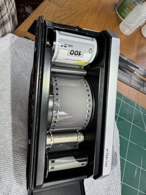

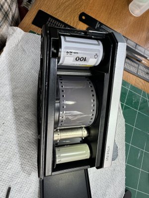

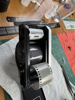

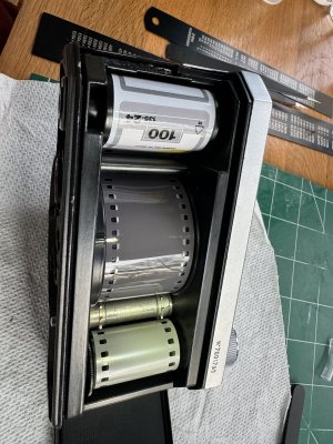

I can’t figure out this problem.
After reassembling and test firing a couple of time, I loaded film and after the first exposure the shutter release was jambed.
Another round of disassembly/ reassembly I finally opened the back and noticed the problem is that the film will not stay wound around the take up spool.
I’m pretty certain I have the film loading path correct, hopefully the pictures show that, and take up any slack in the film by winding it back a little to make sure it’s taught before closing the back. But it happens again.
Where’s my mistake?
Could it be the film stock? Are these things that finicky?
