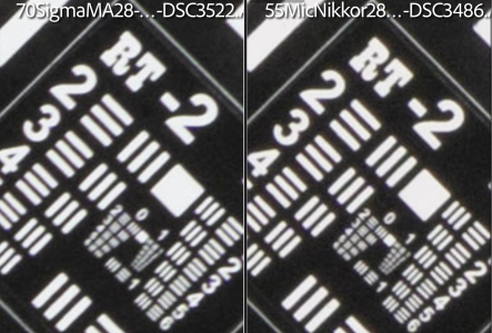

Optics theory about diffraction: Extinction resolution in lp/mm from diffraction will be at 1600/f-eff where f-eff is the effective f-stop. At 1x, the effective f-stop is double the number set on the lens. So, f/8 set on lens is f/16 effective and the resolution is limited to 100 lp/mm. The sensor also limits resolution; a 50MPx sensor has an absolute resolution limit ("Nyquist limit") of about 125 lp/mm, practical limit is somewhat less.
I read resolution of 91 lp/mm and some detail a little finer with the 70 Sigma. The results look about the same from f/4 to f/8, so I think f/8 is best for camera-scanning to give a bit of DOF to handle film not perfectly flat.
My point is that while better lenses will produce better files, I think we get pretty good cam-scans with lenses down to Group 3. My example lens, the 75 Vivitar Flat Field Lens is between group 3 and 4 in resolution.

All very good questions... I had access to a 60 f/2.8 Micro-Nikkor AF for a short while. I was only able to test at 1x in mid-corner with a 50MPx sensor. The results were excellent resolution (91 lp/mm on glass USAF target) with good contrast. 70 Sigma Macro ART was a little better contrast in same conditions. I no longer have access to this lens.
I have several 55 Micro-Nikkors. In my tests at 1x and 0.67x to 24MPx sensor, the 55 f/2.8 is top-notch, all the way to the corners, equal to the 70 Sigma Macro ART. Here at 0.67x, f/5.6, Vlad's Test Target, to 24MPx sensor (Sony A6000). This result G0-E2 (62 lp/mm) is typical of best lenses in these test conditions.
This thread was "How great a lens do we need?" and both these lenses will give excellent cam-scan results for real film shots to 24MPx sensors.

But you raise a good question; what happens if we are more demanding? Now with a higher res camera body (Sony A7R-IV) I have the same test at 61MPx. In this, the 55 f/2.8 Micro-Nikkor is quite good, but not quite as good as the 70 Sigma. This is Vlad's test target, the resolution of the 70 Sigma is close to the limit of the target G0-E4 78 lp/mm. Here's the comparison 1x, f/8, 61MPx sensor.

Here is the 55 f/3.5 Micro-Nikkor, LEFT at 1:1.5 for 35mm to APS, RIGHT at 1x for 35mm to FF body. Both at f/8.
