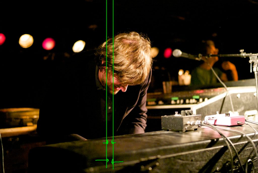

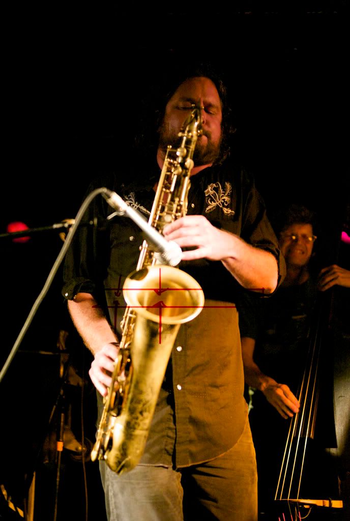

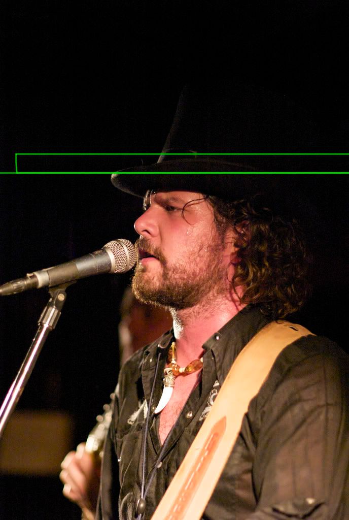

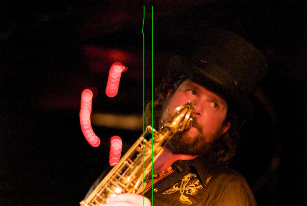

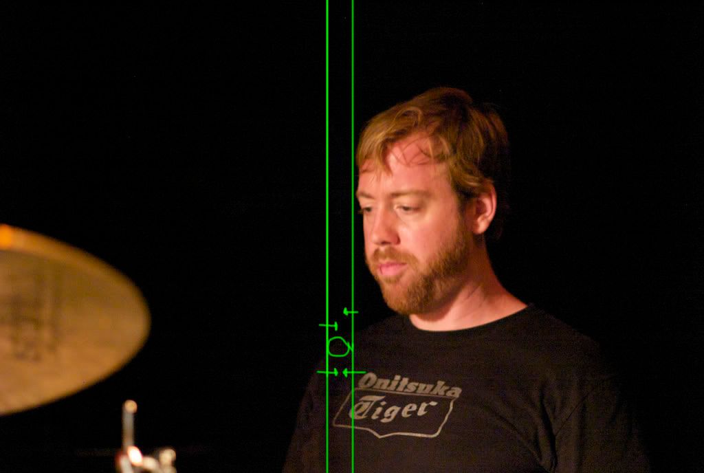

yeah, you're right - it does exhibit banding in bad exposures more so than good ones, but still. i think it should be dead pixel and banding free. i'll have some images up in a moment, as soon as they're hosted...
oh, trust me I agree with you that sensors should be banding noise free, the problem is that the technology isn't there 100% yet. Some manufacturers have figured out ways to cleverly reduce it with algorithms (capture one pro has banding noise suppression in it's noise reduction area...that alone should say it's a problem with more than just the m8's sensor) Banding noise is just something where digital blows chunks (trust me I'm not bashing digital, just a limitation) and I've seen it from all digital sensors, from my iphone to the wifes 1ds mkIII (which for 3 grand more than an m8 should be better at it, but it's not)
Oh...it's also much much MUCH worse in cases where a light source is predominately one color (red, green, or blue) and seems to stem from the fact that ccd and cmos sensors aren't quite as swank as those foveon sensors (sorry, I just woke up, my brain isn't quite capable yet of forming proper sentences or thoughts :) )
btw...your flickr shots are amazing.

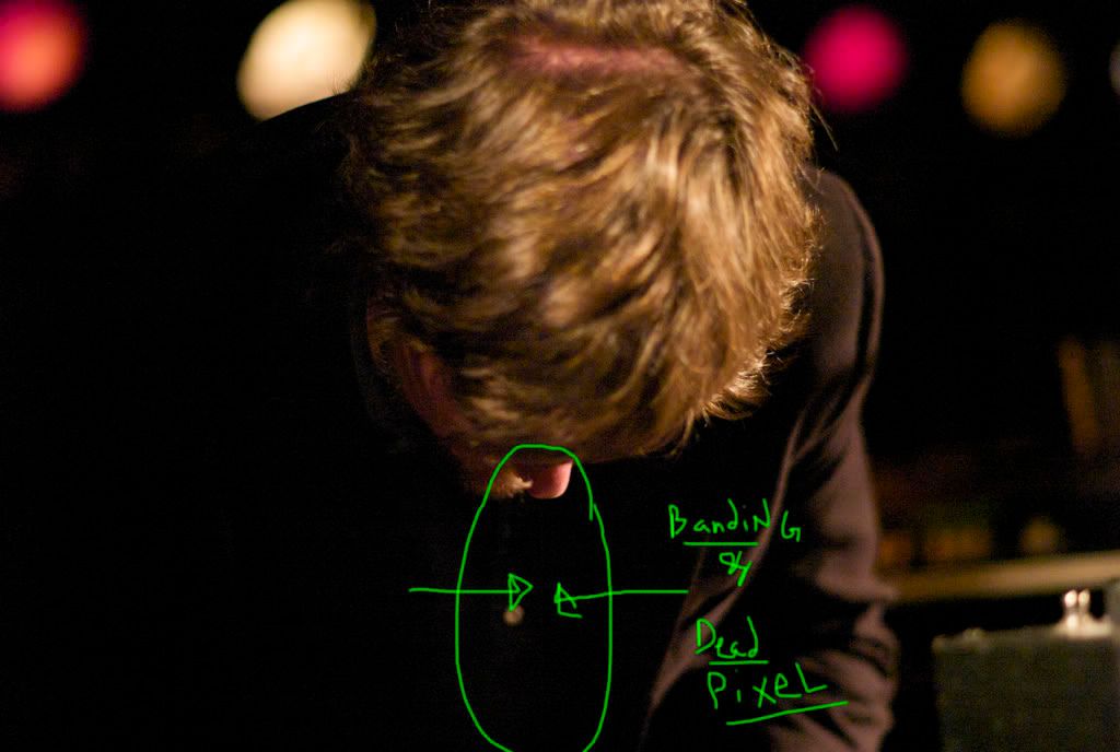

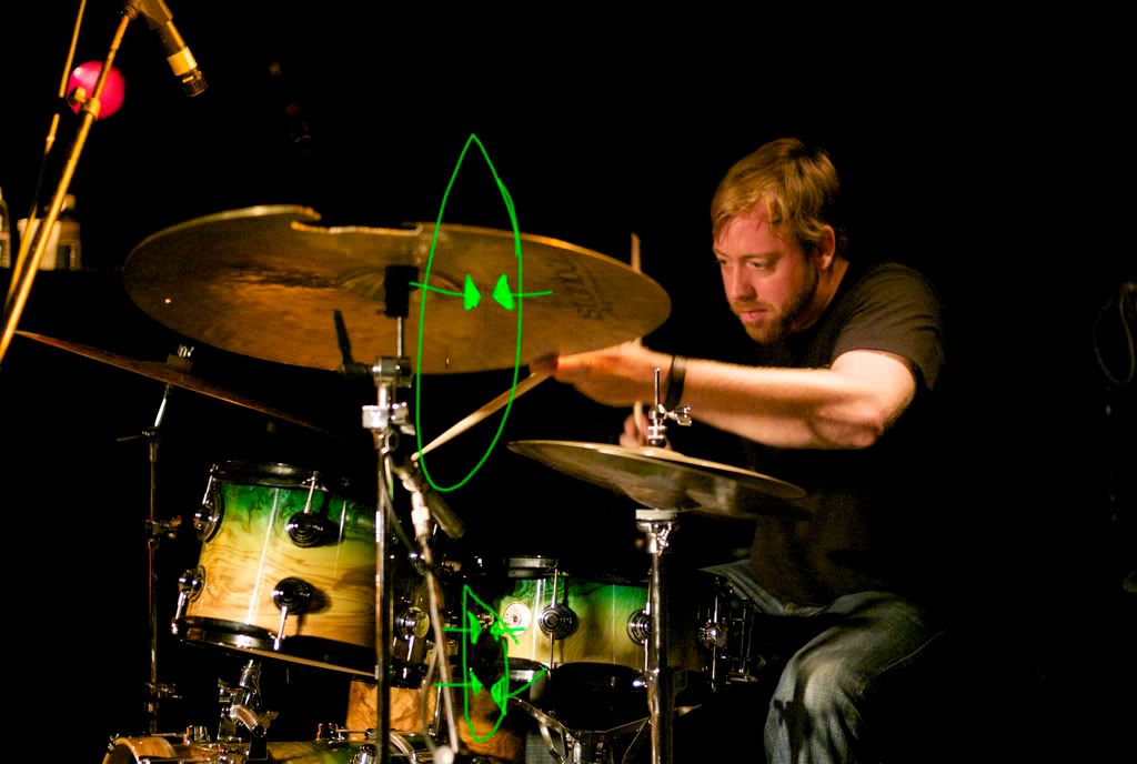

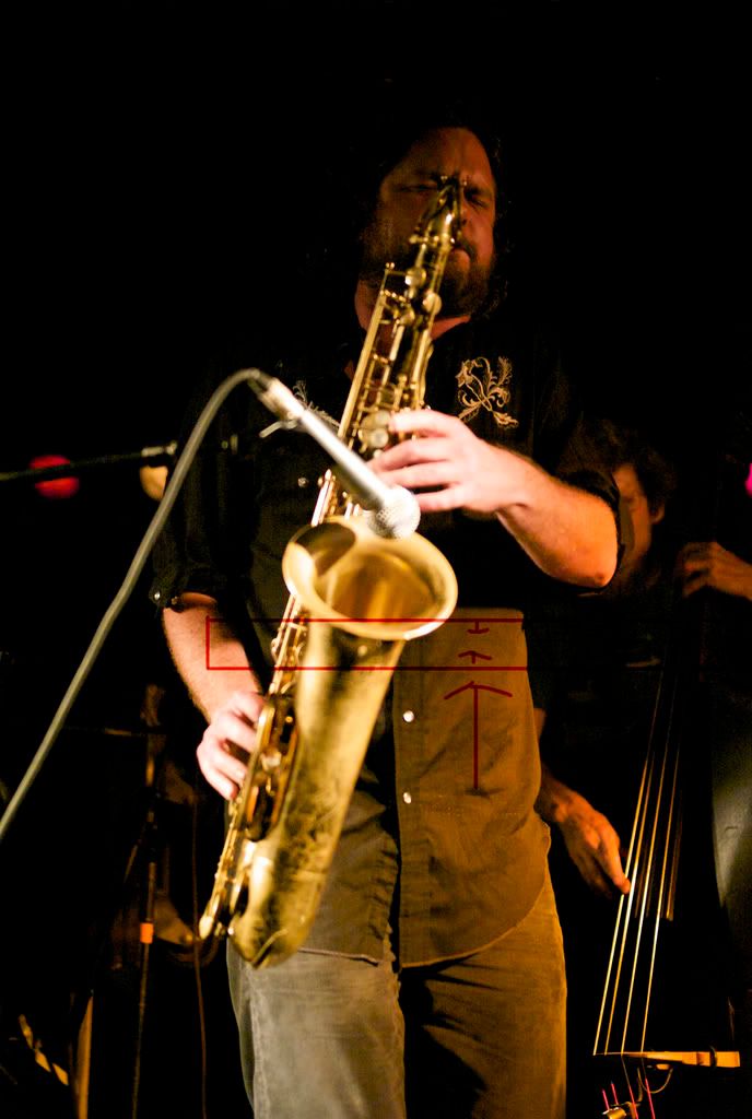

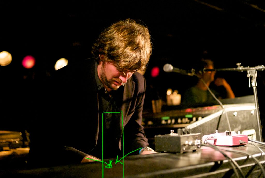

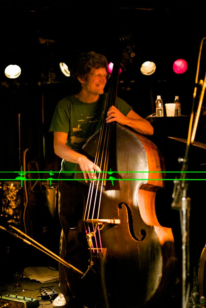

i tried to highlight these things in photoshop.
but i think the stronger colors make it so one can't see the issues,
but trust me - in aperture - with a loupe they're clear, well they're clear on a big screen regardless...
thanks
thanks
send them back. this is why i wanted a picture, i thought it was just lousy noise performance (i thought you were talking about banding noise)...it's not, those be some funky pixels...i am however curious as to why those wouldn't show up in lower ISO's though...hmm I'd just send them back one at a time. (I certainly would if i had red and green arrows showing up on my sensor :) )
i hope they resolve this issue for you...some people may not notice that or claim it's a minor annoyance, but that banding is pretty bogus...i certainly wouldn't settle for it...Though I have to ask you one other thing...have you updated to the latest firmware? I could be very wrong, but I recall reading somewhere that updated firmware fixed some of this problem...and just so you know not all m8's are bad...mine does not have this problem...either way I hope you get it fixed.
Is the banding always in the same place? Looks more like rows of questionable pixels than banding to me. That would certainly explain why it happens more at higher ISOs - more amplification of the noisy signal.
