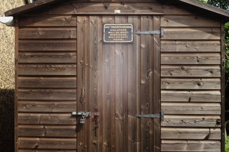

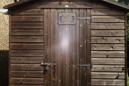

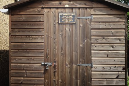

While looking through my late fathers photographic odds and ends I found a Industar 26M 52mm f/2.8 lens.
Using a LTM adapter on my M-P 240 I tested it and was surprised at some of the results.
Knowing this lens like many Soviet lenses flare in bright conditions, so I fitted a Soviet plastic lens hood. These shots of the shed were taken with sun behind me, so you would think with a hood this wouldn't happen. Stopped down this issue gets worse, I've never seen anything like it before!
Images above f/2.8 - f/11 - f/22 ...Into the direction of the sun, I would expect flare, not from behind.
Indoors or away from sunlight this lens is perfectly OK to use. Lens elements look OK for a Russian lens and it's age.
In all the years I've used cameras, including ones from the former Soviet Union, I don't think I have ever seen anything quite like it. My Jupiter 8 or Jupiter 3+ 50mm lenses have never flared like this before.
I can't work this out, is this a digital thing or flaw in the glass?

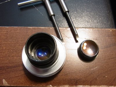

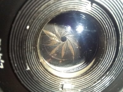

I had this problem with the Helios-103, the aperture blades were shiny, stopping down caused reflections that "lit up" the optics. I used a Black Marker to get rid of the problem. You lens looks like it has some haze. Post a picture of the Blades when the lens is stopped down to F16- would help.
I had this problem with the Helios-103, the aperture blades were shiny, stopping down caused reflections that "lit up" the optics. I used a Black Marker to get rid of the problem. Post a picture of the Blades when the lens is stopped down to F16- would help.

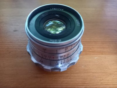

This might be the answer then, wear on the blades? Certainly from front (left image) you can see a fair amount of wear on them.
I'll have to bare it mind when using this lens, although I will say I do tend to shoot wide open most of the time.

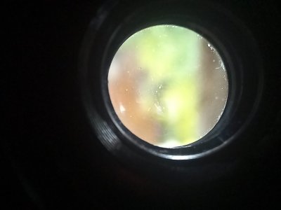

Yes, there is a small amount of dust and haze. Don't think I'll attempt disassembly myself, I'd have to send it off to be serviced at some point.

That is likely the problem. This is not a difficult lens to work on, but you do need an optical spanner- about $25 or so off Ebay.
  • Like
Reactions: MNS
Youtube for now...
I need to post the instructions in my forum.
To solve your problem, the haze is most likely on the surfaces on each side of the aperture.
Once you have a Spanner, this is a 2-minute operation. The I-26m does not have a rear baffle, like the I-61L/D has. SO- even with the barrel in the focus mount, easy to take it out. The rear element is in the fixture, so does not come out as a loose piece of glass. Did this as I was posting.
