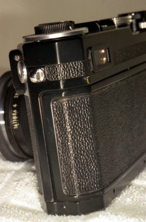

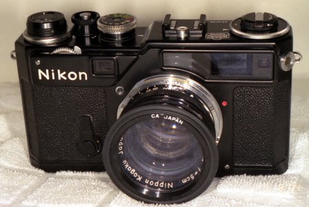

Pictures for comparison. Taken with my N8008s and SB-29, 20 years ago. I still have the camera.
Shintaro did not paint (redo) the sections already painted Black on the original Chrome SP. The Yellow under the chipped paint, lower-left of the VF- is original.
I picked up this camera, near mint "except" a dent on the nameplate. Shintaro removed the dent, then painted it. Was worth it to me to have the dent removed.
