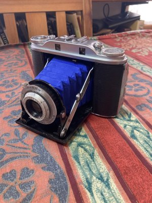

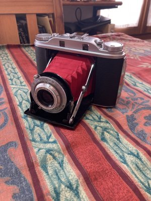

I have both a Super Isolette and an Iskra and have never changed the bellows in either. BUT I have replaced many Isolette bellows with ones from lesser 6x6 cameras (Kodaks mostly) and also ones in Ikontas. My experience is that most 6x6 bellows can be moved to other cameras if removed with care. However it can also be fun to make your own!
