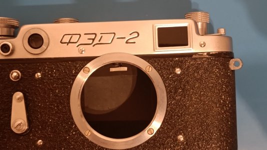

Ok so finally could take photos. So diameter of glass element is 29.95mm on my copy:
Here's how it looks on minimal distance and infinity:
It screws into camera but when lense is focusing close to minimal distance (i.e. max rangefinder arm movement into the lense side) i can feel and see (rangefinder image "skips") when focusing. I don't thing there's anything particularly odd about rangefinder arm - it probably just lacks tiny clearence
Check that the screw holding the arm is tight- to rule out play in the arm.
