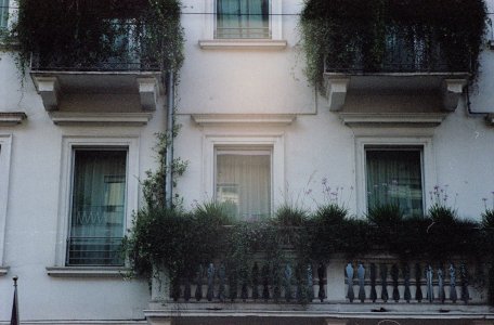

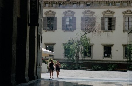

I am specifically commenting on the intense "flare" which I have obtained even with no light source anywhere near the image area. Examining the lens + adapter system, I see that even though I have blacked out the internal reflective surfaces of both with India ink, it still seems to reflect light from the primary image circle off the sides of the lens + mount toward the film plane. This has led me to place adhesive flocking material on the inner surfaces of the long tele hood, the focus mount, and the adapter. On initial examination, this seems to help.
I am wondering whether this "flare" which seems to be internal reflections from the image circle, is a result of this lens having a larger image circle as I seem to remember reading that longer focal length lenses have. These are at f5.6 - f8 ish, but I have seen similar internal reflections using f2 with the lens alone and viewing from the rear of the lens. The camera was a M2, which had no light leaks evident when using my old prewar Sonnar 50 1.5 with beautiful oxidation on the glass elements during the exact same trip.
On the attached examples, the flare seems to be a reflection of the image circle of the sky in an area that is beyond the film borders.
I'd love some input.

Here are some examples from the same roll, where it did not occur to the best of my knowledge. All of these are basically uncropped full-frame.

I bought an inexpensive Chinese Adapter which caused flare with some lenses, the CZJ 8.5cm F4 Triotar in Contax mount being the worst.
The inner portion of the adapter was not pained, was shiny. I blackened it, and flare was gone.
For some reason that was not sufficient here. Weird and surprising!
A few of my points to the respected community -
Jupiter 9 often has flare with loss of contrast, this is mainly due to poor blackening of the inside of the housing at the back of the lens (or the paint has simply peeled off over time)
By changing (increasing or decreasing) the distance between the last lens and the penultimate one, you can increase the sharpness in the near field (up to 3-5 meters) of focusing.
Just wanted to add that the original (pre-war and war-time) Sonnar 85/2 has similar flare. I found that one of the differences between the versions that flared a lot and those that flared a little was the presence (less flare) or absence (more flare) of a rifling like texture in the rear barrel that engages with the Contax bayonet.
It seems to me that the image circle of both the Jupiter-9 and the Sonnar 85 is much larger than required - causing a lot of extra light to bounce around inside the camera and optical system. For example both lenses can be used on the Fuji GFX (close to 645) with no vignette
To further reduce the flare you could consider gluing in some soft light-absorbent material such as blackened linen or similar. I've done this and had decent results.
