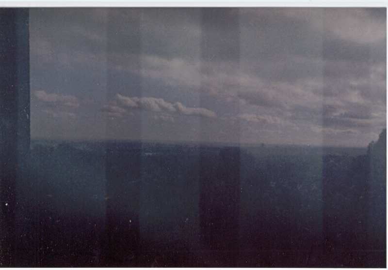

I have seen it once on the slide above (The colored stripes to the left are from the scanner) there is also the darkened sky.
What i notice is that it appeared in this shot, directly against the sunset, only.
I think this shot was made with the jupiter 12 lens and my jupiter 12 has no scratches or dents in the glass itself, but the paint on the edge of the rear element is in a poor condition. I suggest maybe this could be the light-leak ?

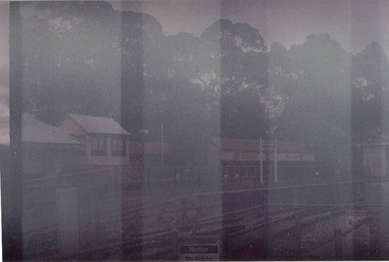

I don't know the answer to the problem but this started to happen to my Kiev before the shutters completely seized and died.

Does the banding expand into the sprockets? Or is confined to the image area?

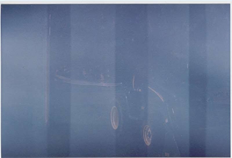

Heavily misexposed, in any case - but it is hard to tell which way in a print, as the printer will compensate the exposure either way towards the average.
Are the negatives extremely dense/fogged, or very thin? If the former, it seems to be a light leakage issue (presumably vertically on either spool side, affecting the film in transport). If the latter, the shutter blinds are effectively stuck close and what limited exposure you get is from the leakage through the seam formed by the blinds' imperfections.

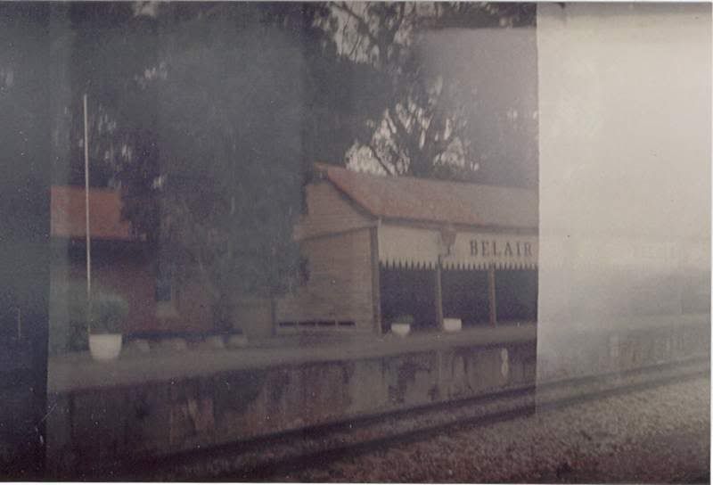

Thanks Sevo - the first few shots on the roll were fine. It's hard to tell what happened - after opening the back of the camera the second shutter would lag heavily at low speeds - and after a while it just seized the camera. Not worth repairing unfortunately. The lens of course, is still good. I'll get another body from Oleg at some stage.

I think that there is light getting in between the shutter slats--forget a CLA, buy another body from someone like Oleg at OK Cameras-he knows Kievs back to front. Happy hunting without the stress!

My money's on the camera being "repaired" by someone at home and then put back wrongly. Kiev's are (?simplified) versions of the Contax design and that was noticeable for complexity. So hardly the best one to learn camera repairing on.
