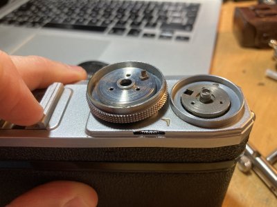

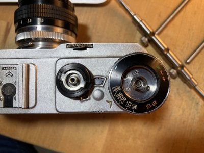

Maybe these will help:
This is what you see after removing the shutter button itself with a pin spanner. Those three screws are annoyingly sized - a 0.23mm x 2.0mm screwdriver is what you're looking for. Wera make a 0.23x1.5 and a 0.3x2.0, but not that perfect combination. Urgh.
Removing the shutter dial gives you this. Hopefully that pin is the problem - it'll require a donor shutter speed dial, but at least you won't have to go further down.
The pin is quite long - maybe yours has lost the tip and isn't engaging fully, or the slot it sits in is worn. Or it could just be that the dial itself isn't going far down enough; that'd be a nice and simple job if it's just because those three screws were loose!
That is absolutely awesome! Thank you so much for this. At least I know what I'm looking for now.
I finished taking the knob off this morning and found the post is not sheared or bent and when I insert a screwdriver into the slot where the post sits it still continues to rotate without cocking the shutter. There must be something else bent or broken in the shutter cocking mechanism. The next steps would be removing the rewind knob and pulling the top cover so that I can get to the top casting and shutter cover. I'm not sure I am ready to go any further right now since I already have two good working examples of a Contax II. Couple that with the fact that I am not exactly a camera repair person and you have a perfect recipe for a disaster.
