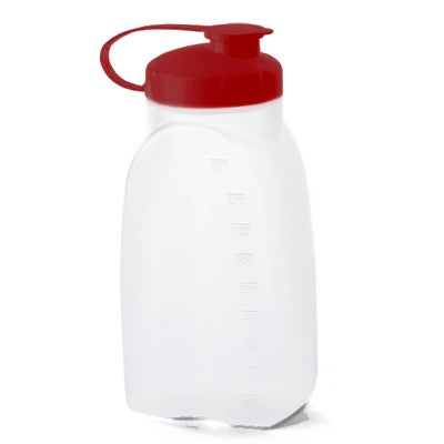

Yes - I'm definitely using dedicated containers. I wouldn't risk mixing E6 chemistry and food. I went to the Container Store and got 7 of these 1 liter bottles so I can mix the E6 in five separate 1 liter batches. (I use wine-saver argon gas to top off the Kodak bottles. I expect to get through the whole batch in a couple of weeks anyhow.)
But since I'm not doing darkroom development, my major concern are the two developers and whether they can sit in the light for an hour while they warm up. The containers are not opaque. I would use Datatainers for the developers, but they are graded in ounces and I can't fit a whole liter in their 32 oz. bottle. (And the next size up is too big.)
