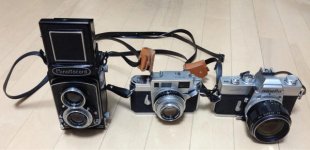

I have the 48mm 2.0 as I live In Japan and went with the domestic version. It's indeed more difficult to get repair for unfortunately. Perhaps more expensive too. I'll try to get a repair locally from Jeff who offered his services above. Very excited to have it in tip top shape!
This is a pic of my slowly growing kit...
