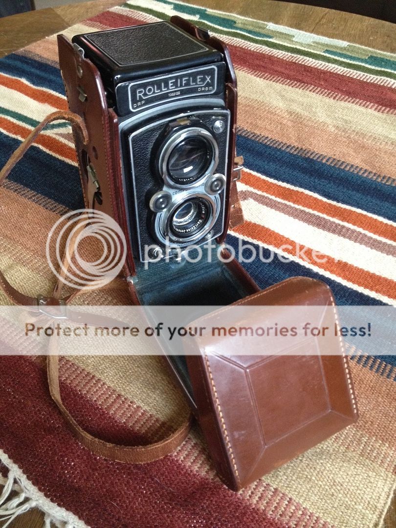

I just spent some time cleaning up an old Rolleiflex I bought recently. What can I use to revitalize the camera's black body covering, and the brown camera case?
I just spent some time cleaning up an old Rolleiflex I bought recently. What can I use to revitalize the camera's body covering, and the camera case?
I went on research not so long time ago. Some cases where due to.
You'll need to go to horsies store and they have it for saddle and else.
I forgot the name, but it is the only one they have at the stores here.
I could check it tonight.
UPD: Must be the Lexol. I put it on very similar case as yours 🙂
I use leather creme made for shoes, not the hard pollish but the the soft creme. Leave it for a whie and rub the excess of. Makes the leather soft again. Some old camera cases were treated with laquer though so be careful
What's wrong with mink oil? I never heard anything - granted I haven't used it all that much. It did bring a dead Billingham back to Life - the leather parts were so dry they were cracked. This forum suggested I try that oil
According to my friend that buys, trades, collects and sells historic WWII leather flight jackets and he has had historic jackets worth over 10K wont buy a jacket if he finds out that it has had mink oil on it. He also wont use it to treat 70+ year old jackets. According to him and other collectors it rots the tread and actually winds up eventually drying out the leather and promoting what he calls red rot.
I won't use it because trust his opinion.
I like Lexol on old camera casas and old gun holsters as well. If it is really bad off, it may take more than one application.
I have used mink oil on shoes in the fall and winter with no problems so far. Of course I keep my shoe leather well protected by leather polish. In shoes, I also have several pairs of shoes and rotate their use. Surprising how that increases their life-time.
