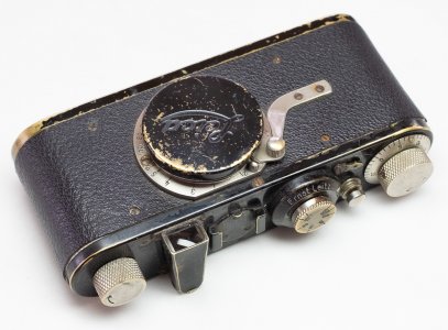

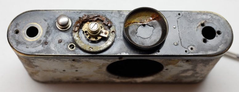

Funny thing seeing this thread pop up now. I'm in the process of taking apart my 1930 A, a crusty example that was exposed to sea water. I think that with fresh curtains and a proper cleaning of all parts it will work again. If anyone has questions about getting into one of these oldies maybe I can help.
View attachment 4840851View attachment 4840854View attachment 4840852
Oh my goodness, that looks really sad. Especially the outer case. Has the sea water corroded away any of the material?
Best,
