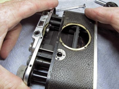

Hi. Started to disassemble Leica II syn (converted from Leica I), and stuck on removing shell - looks like there is a screw behind the black circle on the front of the camera. How to open it? Don't want to force anything and can't find exact examples. Most of the photos from disassembling are about models with slow speeds or model F, which has different shell. Please advice.
On the younger IIIc/f/g-style models there is generally nothing holding the shell onto the body if you have removed all the screws like in your photo.
But there are screws hiding under the round piece of leatherette of the "slow speed dial cover" that hold the circular metal disc onto the shutter crate, it also covers the 4th (top left) screw that holds the shell to the crate.

Do you think I need to remove the circle piece of leatherette to get access to the screws? I can see some screw coming out from the inside with flashlight, but it is covered with this circle patch from the outside.
Yes, remove the circle of vulcanite and remove the fourth, larger, screw. From memory you can, l think, leave the three other small ones in place.
When sliding the shell down be careful of the rangefinder cam.
  • Like
Reactions: dab
Ok, great. It is free from the shell now. There was 3 screws holding the metal disk, behind the vulcanite. And another screw under the metal disk. It was holding the shell. Same way as on the photo from TunnelBlog, just without the knob for slow speeds.
