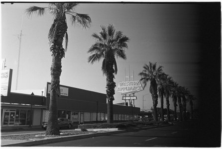

Hi, It looks like exactly the same issue I see my IIIf recently serviced by one of DAG's colleague/ competitor ... I am still testing it and thinking about next step.
Did you record the speed used on each frames ? on mine, 1/1000 and 1/500 show the problem, things get better at 1/200.
Shooting vertically seems to help.

Very heavy capping on the few frames that it happened, and they were all in a row for six frames, then it fixed itself. Except all my exposures were off by at least a stop. Don't know if I might have used the wrong shutter speed (I shoot mainly using Sunny-16, and I could have set the camera up for 100 ISO), or if the actual speeds are off. It's hard to figure out on a Barnack body. One needs the right equipment to accurately judge shutter speeds on a III series camera. Plus, I would like the flash sync to work again just in case the situation for using it comes up. I hate to think I wasted all that money on a Metz flash with the Leica III PC cord adapter.

I'm inclined to say it's a lubrication issue, not a tension one.
I took a IIIf to Aperture in London back in 2015 or 2016. They got it "working" again, but not only was it a LOT louder, within a year or so it needed another service. Needless to say, I took it somewhere else that time, and it ran much better - until a liquid electrical tape "patch" repair done by a previous owner failed in 2022, necessitating a brand new shutter.
I think Aperture had basically just tightened up the tension on the shutter to make it power through dried-up old lubricant (hence the increased shutter noise), and as that old grease continued to age, it just became unusable again. If your guy did the same thing, it'd make some sense that with some "exercise", things started moving again as the old lubricant eased up a bit.
I agree with this. A clean and properly lubed shutter system should work with relatively light tensions. I also wonder if the fellow who serviced farlymac's IIIf used a shutter tester to check and adjust the speeds.

Farlymac, If I were in your shoes I'd go with DAG or Sherry K.

Mine is well lubed as it just came back from service ($200, 7 months lead time) ... I don't know how shutter capping can be tested but repairman confirmed that he doesn't run a film test before sending camera back. I love this small camera, will most likely bite to the bullet and send it to DAG (should have sent it to him directly, his quote was $500).

Well, it was serviced by YYE ... who told me - $200 and 7 months later - that the camera was "well used" and I should get one in better condition ...
I am very happy to report than my IIIf came back from DAG last June: shutter capping issue is gone !

This is sadly, especially now that the information is everywhere on the internet a scourge on almost all cameras. Be it Leicas, Contaxes or Canons or other rangefinders.
Jack up the curtain tension to max and sell it on or take whatever money for the "repair". You now have a loud, intermittent ticking time-bomb that also likely will feel rough to wind/use.
What follows is various posts in claiming that these cameras are "unreliable" - when they really aren't. All of these golden age rangefinders are very reliable in my experience. But they absolutely do need proper service with a clean-out, relube and proper setting up of tensions and timings.
