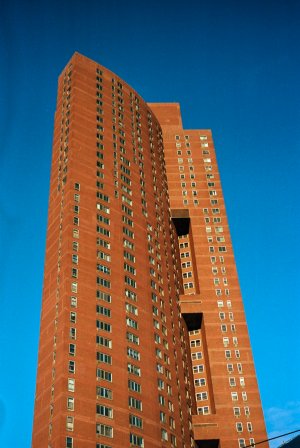

Hi everyone,
I’m reaching out to the community for some advice regarding a persistent shutter capping issue with my Leica M4. I’ve had the camera serviced twice by two different repair shops, both of which performed a CLA (Clean, Lubricate, and Adjust), but unfortunately, the problem still persists.
The first repair shop, which is less known, refused to acknowledge that the shutter capping issue was occurring at all. The second shop, which is very well-known in the community, admitted to the issue but said the camera was too old to properly fix.

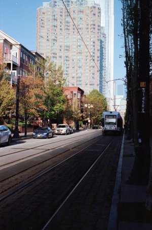

I’ve attached two photos to this post: one taken after the first CLA and the other after the second CLA. You can clearly see that the issue remains unresolved.
Has anyone else experienced something similar? Any advice on what steps I should take next would be greatly appreciated.
Thanks in advance for your help!

3. I don't see any issue with the two photos you posted.
Can you give us a description of how the images are affected?
+1
I thought at first the "issue" was the darker area at the top of the photo of the high-rise building, but if you look closely, there are darker lines running the length of the frame on both images.

It's not technically capping (although you can see this frame was very uneven across the exposure alongside the "striping" issue); it occurs when the edge of one shutter blind isn't perfectly straight (a rough/uneven bit of curtain material wrapped around the lath at the end, for instance), and is made worse when the two shutter curtains are running especially close together (as the uneven end of one curtain makes the gap slightly smaller and wider at intervals throughout the frame).
Either way, if that is what the problem is here, it's completely fixable, and frankly, any technician who says it isn't is lying to you (or doesn't know what the hell they're talking about).

The photos and the film itself have a form of banding. I have more photos, tomorrow I’ll post them.

I looked closely at both your pictures -- sorry but I can't see anything going on in the second photo (with the streetcar). Maybe shoot into a completely blue sky and that would more clearly show the issue to us.
