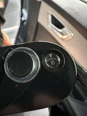

Hello guys, I’ve just acquired a new Leica m7 black paint a la carte from a reputable seller in Hong Kong. I was shooting yesterday and I realized that the film counter is not aligned with the arrow. This is my second m7 and I don’t remember that the other one has this issue. The camera came with the Leica certificate that came out from Germany in September 2024. What you guys think? I’ve seen other cameras with this “issue”, but I’m looking for more information on this. The camera is working good whatsoever.
maybe is just an aesthetic issue…
My M6 frame counter stopped moving altogether. Apparently it’s a disc glued to a shaft with small contact area. Not their best design. I suspect this m7 was repaired without proper care for the alignment. Always liked the timeless simplicity of my M2 frame counter. I’ve never seen an M7 I would buy. All the ones I’ve seen online seem to have a problem where the body covering is peeling away from the edge near the top cover containing the frame line illumination window, and otherwise beginning to peel from the back door. That sort of thing would drive me mad. I don’t see it with other M Leicas for sale.
First production batch M7 are known for ISO dial issues and in case of black chrome finish, the finish can literally been wiped off. My M7, bought as Leica refurbished and upgraded to optical DX reader and MP-style VF, had the ISO dial issue and was sent to Leica Germany under the one year warranty provided. They weren't able to fix it but after their repair attempt, the frames were slightly off-set and no longer aligning perfectly with the sprocket holes as they were prior to the repair. Later Leica Japan did a quick fix by tightening the screw that holds the ISO dial mechanism and this fix lasted at least for a couple of month. My M-A had out-of-box a horizontally misaligned RF and focus was off. At least Leica Japan was able to adjust it.
The misaligned frame-counter, never seen this issue before. It is the a-la-carte option black frame counter, maybe somebody was in a hurry assembling the camera? Better check for other issues too.
