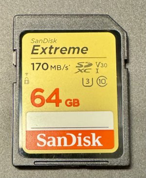

With a 95 MB/s card, the M246 startup time was brought down to less than two seconds now. However, the high speed card seems to introduce banding in the shadow on in DNG when images are pushed two or more stops in LR6 (& when I blow it up). I found at least one other user mentioned this phenomenon, when I googled it. It probably would not be a problem when I print the images, but thought that I should bring it up here.

Wanted to report back on the banding issue of my SanDisk 95 MB/s card. It did not get resolved by changing over to a Transcend 90 MB/s card (suggested by someone in another forum). 90% of the banding (pretty minor to begin with) go away after applying debanding using Dfine 2.0.
