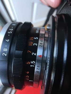

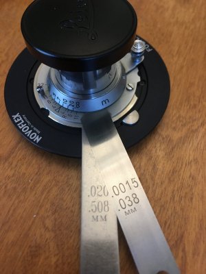

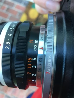

@peterm1 I hope the Urth adapter works for you. I have a few Urth adapters, but only the passive type. Pentax K to L, Leica M to L, Minolta MD to L. They all have a tiny bit of play in some form or another - the mount to the camera on all the adapters is a little 'thick' if that makes sense, as in it needs to be turned firmly into place in order to work. And the Leica M to L adapter has a bit of play in the M mount end, which doesn't seem to affect image quality, but is noticeable in manual focus.
Hopefully I will see soon. Many "dumb" adapters I have tried over the years have a slight amount of play in them too - even the K and F concept, 7 Artisans and TTArtisans ones which all tend to be a cut above the "no-name alternatives" in terms of their construction. Almost always this is in the rotational direction (i.e. if the lens is twisted these can be a slight amount of rotational / circumferential movement in the adapter and or the lens - I put this down to the locking pin hole in the adapter being slightly larger than the locking pin itself thus allowing this slight movement. Like you I have not found this to be deleterious - the only circumstance where I would expect it to be would be if the lens/adapter pair was being rotated as I pressed the shutter when using a slow shutter speed. Forwards and backwards movement would be much worse for obvious reasons as it might allow the lens to move out of plane with the sensor.
Incidentally, with some cheaper dumb adapters I have owned in the past, I have had one or two that had difficulty mounting on cameras in the way you mention - this is due to the underside of the lug on the adapter (which engages with a corresponding lug on the camera) being slightly out of tolerance - usually by the tiniest of tiny amounts which is enough to mess it up. With dumb adapters this can be corrected quite easily, and I have done so in the past....................I have a diamond plate knife sharpener in which the diamond plate has become detached from the plastic backing on which it is supposed to be mounted.
When removed in the above manner the diamond impregnated plate is perhaps a 0.5mm thick - thin enough to slip under the lugs on the adapter to "lap" the underside of these lugs. Sounds sketchy I know but as long as you are methodical and careful - as in making (say) five careful swipes with the diamond lapping plate on a randomly selected first lug, then after 5 (or however many you choose) then move onto the next adapter lug and repeat with the same number of swipes with the plate on the underside of that lug. Keep moving methodically round and round the adapter, several times and as you get closer, clean the adapter and test its fit on the camera every so often till it fits snugly onto the camera without having to force it. Not sure if this is feasible with an electronic adapter as the contacts may get in the way. In any event it is too expensive - I think I would prefer to just return it to the vendor for a refund given what is at stake.
(Though people often disparage the idea of stacking adapters in this way I have not yet seen any practical downside despite the theoretical limts. This method just works for those lenses that do not require electrical contacts to function but unfortunately does not help me with Canon EF mount lenses lacking an aperture ring.)
