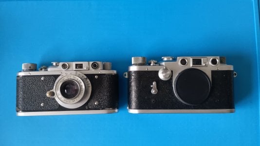

Found some photo of actual Leotax F with spool and it looks to be longer than standard Barnack spools
Camera itself is also higher than standard Leica. Don't have a Leica but here's comparison with Zorki 1 (should be same size as Leica II)

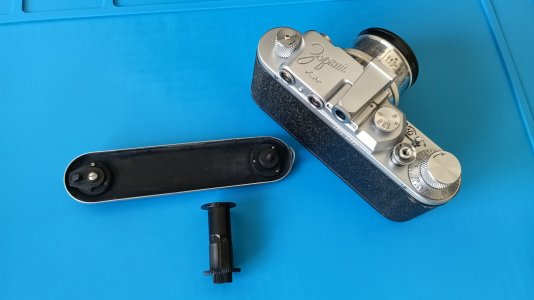

Based on this, I think an early Zorki spool is probably your cheapest bet. Here's a photo of the two side-by-side so you know what to look for:
The Zorki 1 spool is on the left, the Zorki 5 one is on the right. You can see the flat spring on my Zorki spool is pretty knackered (hence the tape underneath!), but it works.

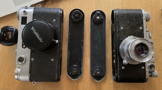

Also, while this is getting away from the Leotax, I'm curious about something: what style of baseplate does your Zorki 1 have? I was surprised to find that the dedicated Zorki cassettes can't be used in my Zorki 1 as it's missing the mechanism to open and close them (as shown on the Zorki 5's baseplate on the left). Really annoying.

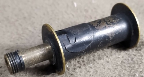

Here's spool I ordered. I live in Poland so shipping from Ukraine is a bit less problematic - though still problematic considering situation there.
Here's my Zorki bottom plate and spool
Hm, that's an interesting one. I've seen that hooked-style leader catch on FED take up spools before, but not one with an extending end before.
I'll be surprised if it fits the Leotax if it's designed for the post-war FEDs, though.
And yeah, your Zorki has the same baseplate as mine. Considering the 5 came out in '58 and my Zorki was made in '51, I wonder when they changed the baseplate to accommodate the cassettes? My guess would be with the introduction of the removable back on the Zorki 3, as the cassette is based on the Contax one - and so is that removable back.
Ok so Soviet spools arrived. Offer was cheap and described as various designs so ordered 2.
Two completely designs indeed
The one with larger opening (left) fits Leotax F. I haven't checked tension but it goes inside the camera.
