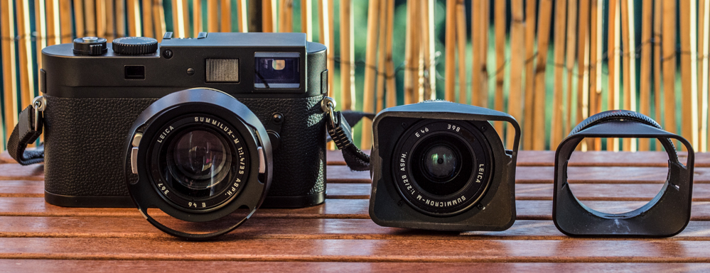

One reason behind the #12466 hood is as a fix to one of Leica's frequent design oversights:
The 28mm Summicron lens is prone to separation - caused by rotational forces between the body and lens hood.
The 35mm ASPH , well at least my early one , also developed a wobble and needed tightening - I suspect for the same reasons ( thought the 35mm hood is the better, i.e. smaller , of the two originals )
The round hood creates less stress on the lens when e.g. it's taken out of a bag.
Given that, the price they charged to correct their mistake is even less acceptable. I admit to biting the bullet and buying one before the limited run of them sold out ... and the price almost doubled ( for once I wish some enterprising machinist in china would sell copies )

I have heard that the hood that comes with the 28mm Summicron might potentially cause stress and that is what is thought to be the reason for the front loosening up. That hood is gigantic. But how does a round hood make any difference over a smaller square hood? I wonder if it's more to do with the screws that hold in the front element unit; i.e., the design of the lens build itself. And maybe too, that some users will tend to grab the lens by the (huge) hood.
But wouldn't a round hood (like the relatively large 12466) also potentially create issues? Isn't it large enough (diameter) to bump the lens when you set down the body on a flat surface?
I'm just curious because I've heard people blame the Leica supplied hood for the lens getting loose but I wonder if that has been quantitatively proven or if it's really more of a lens build issue. Although I guess combined with a big hood that it might become more of an issue.
My thoughts are that the large flats on a rectangular hood are more easily caught and twisted - it's more difficult to catch and turn a smooth round surface.
I think VertovSvliva has it right. Its not that the square design puts more stress on the lens ‘in the bag’, but that users have a tendency to grab the hood when taking the lens on and off the camera. The 4v 35 Summicron is a good example as its a common problem, the front lens mount is held by glue instead of screws. The glue weakens, torqued and age, and the front lens assemble can become loose.
The first time I saw a 12466 was in a very expensive special edition Hermes set Leica-M with a 35 Summilux ASPH. I think Leica was going for the ‘look’ of the more traditional round hood, better made in metal, with the chip-on style, and clip-in hard plastic front cap. Much better than the thin plastic strange rotating lock of the original 35 LUX ASPH hood with its thin front cap that slipped off (and got lost). They probably had made more than they needed and produced some in black chrome for sale - at a price.
The three Hoods : 12466 , 28 Summicron , 35 ASPH
BTW: never lifted or mounted lens holding the hood.
