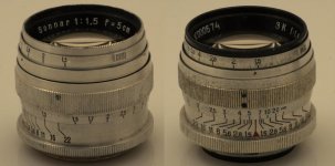

Didn't know that Annual reports could be so funny... or maybe not so funny depending how you read this passage. BTW, I just realized that ZK sounds exactly as a slang word in Russian meaning "a prisoner". I wonder if this is just a coincidence, a black humor or else.
There were four ZK lenses produced by Krasnogorsk plant:
ZK 50/1.5; ZK 50/2; ZK 85/2 and ZK 135/4.
In the old Soviet photography books they stand alone from Jupiter lenses (and they look different)! Being quite similar to German made Sonnars, there are lots of small differences in engravings of numbers, "m" vs. "M", size of red triangle etc. Also, coating of Sonnar is stronger, it is more violet vs. bluish of ZK.
Here are a few pictures of the true Sonnar (on the left) and ZK. The Sonnar underwent a major overhaul recently in the hands of Henry Scherer -- previously the lens didn't focus at all -- he corrected the problem and confirmed its geniuity. The ZK focuses almost perfectly and what's more strange (for the Russian lens) it came with a rear Leica cap. I'm not an expert in rear caps, but it looks it was made in the 40-50s. Now with all these historical reports it looks like the caps were brought to Russia together with lenses in one luggage.
