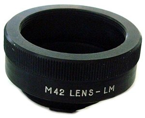

i am trying to do the exact same thing (although i must wait another 2 weeks to get my r-d1). I bought the adapter though, the only one in the market with a reasonable price is the russian one which cost me $70 for 2.
I was a little surprised by the extra distance it would increase between the lens and camera body. i took a picture and you can see how deep the adapter is. The seller guaranteed infinity focus, but i am a little worried that would the focal distance be changed though?
