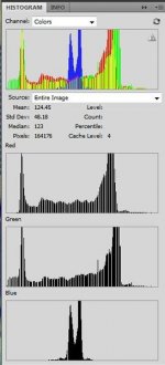

I tried this today and after looking at the histogram I found that the image has a somewhat compressed histogram in the blue channel, but not red and green. It may be because the lighting was a little warm, but it looks quite strange. Any thoughts on that?
It's difficult to show these images because it really depends on how you process it. This is the image after some processing to move the reds and greens closer. The blue will not cooperate.
Side note: This appears to be a problem when I boost the ISO to 2500, but not when I use ISO 160. However, when I take a ISO 160 image and post-process in Photoshop to get higher exposure, I get a pinkish tint as well. So in summary, it appears the response curve on the three channels are not acting in the same way.
