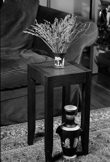

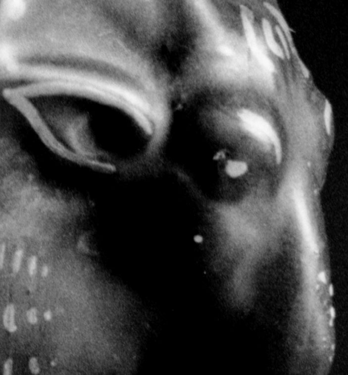

Here are two fairly similar test images from both cameras. They are not identical, because I did them at totally different times, but they may give you an idea as to how they compare.
Fuji 100mm f/3.5
Mamiya 7II 80mm f/4
100% Crop of Fuji picture
100% Crop of Mamiya picture
These were both on Delta 100 I believe. Obviously, the fuji was directly sidelit, and the Mamiya was lit with an indirect source.

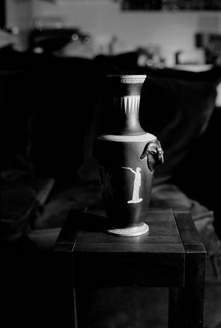

Here is an example of the Fuji and the 180mm lens from 2.5m, it's close focus range (!).

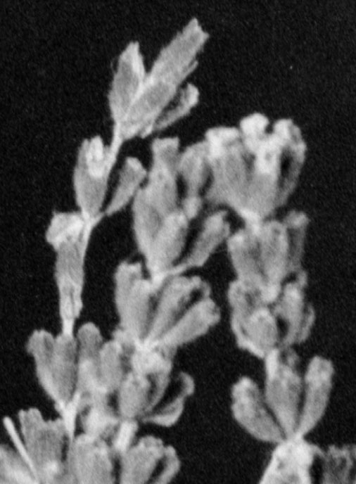

Here is the detail. This is the lavender at the very top center of the bunch.
Edit, by the way, no sharpening applied at all. Images scanned at 4800 dpi using the glass carrier in a Minolta Scan Multi Pro.
