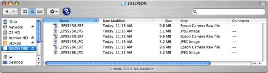

2. When I set "RAW + JPEG," I only see a RAW image file. Should there be two files, one of which I can look at right away in iPhoto and the other I can process later with Elements?

2) Normally I shoot raw only, rather than raw+JPEG, but I tried it just now and it IS supposed to work exactly as you describe -- two files of each shot. I'm attaching a screenshot showing how my memory card displays on my Mac (I assume you're using a Mac since you're using iPhoto.) If you're not seeing this, something must be wrong -- you might want to check your camera settings to make sure it's still set to raw+JPEG and didn't come "unstuck" accidentally.
