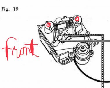

I have always read that Minolta’s CLC metering system consists of two CdS sensors that read the light in two different positions of the frame (one higher and one lower). The advantage would be limited to photographs with a difference in light between the upper and lower parts of the frame: typically, but not only, landscape photos that include the sky. This theory is repeated on many websites and in numerous videos online.
The same information (or almost the same) can be found by querying AI:
“How CLC Works
Two Cells, One Goal: Instead of one cell averaging the whole scene, CLC uses two strategically placed CdS cells to read different parts of the image.
Compensates for Contrast: The system identifies discrepancies between the cells. In high-contrast scenes (like a bright sky), the cell metering the darker foreground is given more sensitivity (often twice as much), ensuring shadows aren't lost.”
However, this has never completely convinced me. First of all, the term CLC indicates something different (Contrast Light Compensator). My impression is that the CLC system allows, through two differently calibrated cells, the reading of both highlights and shadows in different ways, in order to optimize exposure. As a result, the exposure of cameras equipped with the CLC system would be better in the presence of strong lighting contrasts, regardless of their position within the frame.
I have never conducted formal tests, but using both camera bodies with the CLC system (SRT101) and without it (X300s, X300, and X700), my impression is that the CLC system provides better-exposed frames in situations with strong light contrast, regardless of the position in the frame . Minolta itself, in the SRT 101 manual, only refers to high-contrast scenes without providing information on any position of the sensors .
Looking at the image in the manual, could it be that the sensors are actually affected by the position?
The CLC system works very well when the camera is positioned in the landscape mode. It doesn't perform well in the portrait mode because of the placement of the CdS sensors. When I worked for Minolta in the 1960's and 1970's, we were well aware of this situation and instructed Minolta in Japan to include this information in their printed materials.

If you look at the location of the two cds, CRC designed for optimizing landscape with large portion of bright sky in the frame. Like other cds meter systems, the CRC is a very simple but smart design
Correct. This is exactly what the Minolta engineers in Japan factored into the CLC design. Many Japanese amateur photographers use their cameras to photograph landscapes with people in the foreground. Thus, the solution for underexposed foregrounds was CLC.
Raygram-Hornstein, the USA company for Minolta's importing, wholesale distribution and sales, trained our retailers to emphasize the advantages of CLC to their customers, particularly those customers who favored shooting with slide films, where achieving correct exposure is critical.
The success of the SRT line of cameras began in 1966 with the SRT-101 and ran continuously through until 1981 with the budget-priced SRT-100X.
The SRT-101 was so successful that Minolta's USA Headquarters adopted the address of 101 Williams Drive, Ramsey, NJ 07446.
George Williams was the Comptroller for Minolta USA, so the Minolta executives in Japan used George's last name to name their street address in New Jersey.
