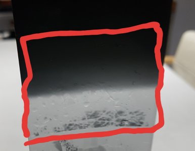

It's pretty safe to say that I am done with Foma 120 films. I shot three Foma 400 films (120) since last year and two came out like you see below. The third one (Foma 200) came out ok. No issues with the Kentmere 400 (120) and HP5 (120).
Has this happened to anyone else? This has put me off from using it again.

As you can see in this bit here, the shutter fired correctly and recorded half an image. On the other Foma with the same issue, the well exposed images started after the damaged part which made me think that I did something wrong with loading. Now I am confident that the films were toasted...

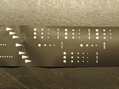

With Foma 400-120 I had 2 parallel lines in the negatives, visible in the backing paper, too. Definately not caused by my camera, as I used different ones and had the same issue. See this problem with Lomo Potsdam Kino, too.
I buy Kentmere now and have no problems at all. However, the numbers on the backing paper of Harman made films are printed very thin, which makes it difficult when using a camera with red window.

I have shot some foma400 in the past and they were mostly ok - some issues like the ones i post further down this comment but nothing that GIMP could not sort. But over the last two years i get lemons of half exposed rolls 😒
@Sanug I had issues with lines/scratches witn Foma 200 years ago. Nothing recently though.
@trix4ever : is it this what you call "lumps of emultion"? Look like dry water spots but they are not. i do get this blobs of low contrast often with Foma400 and takes some time to clone it out in GIMP. Strangely enough, the Foma100 has been the only one i haven't had any issues with (yet).
